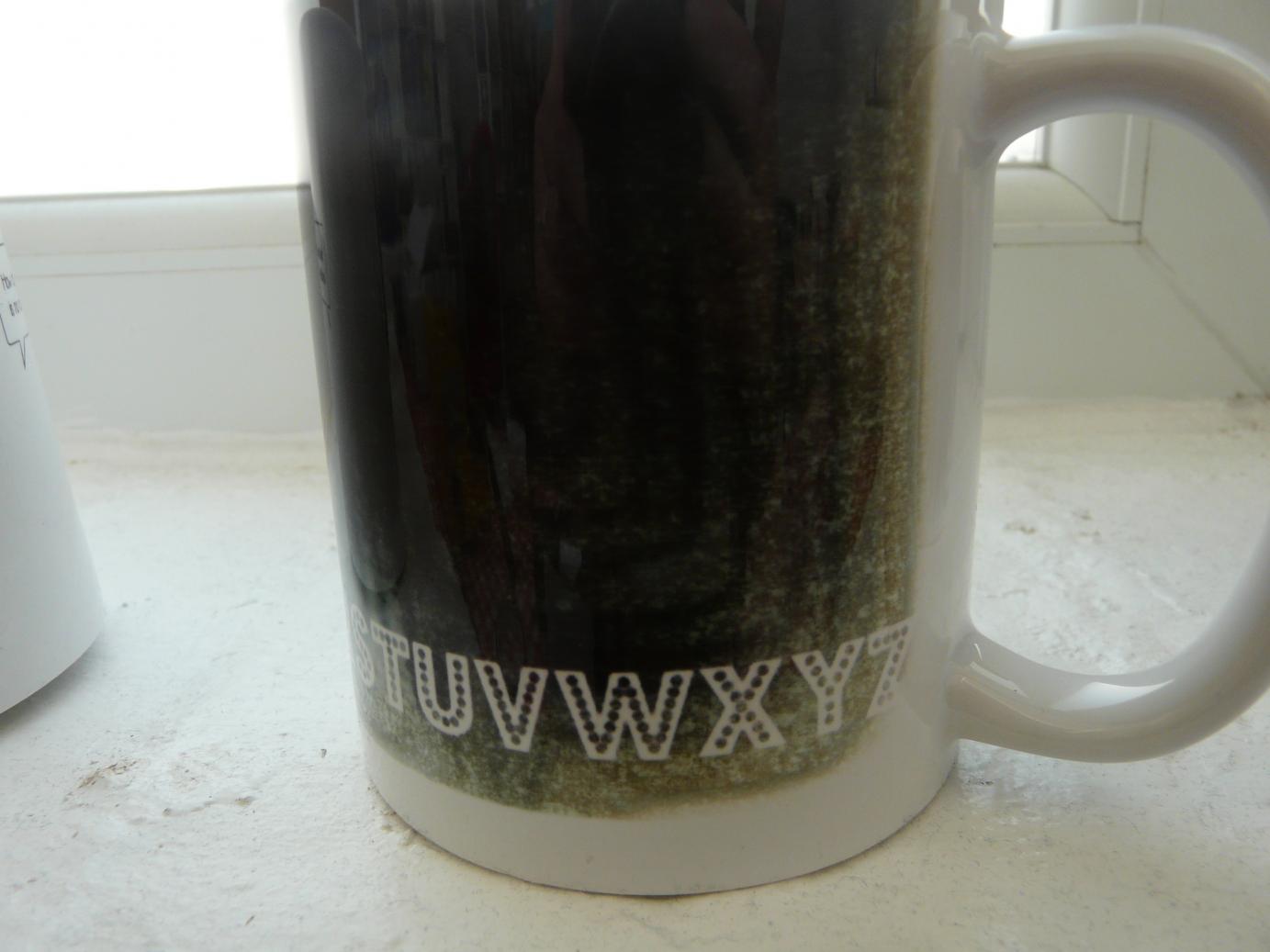

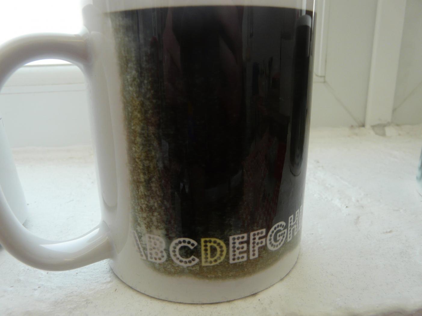

Flipping can be useful where blankets/mugs are less than perfect but you shouldn't be having these issues. have you spoken to Xpres tech. support for their advice? Overlapping shouldn't cause a problem other than possible blow out under the mug. What pressure are you using? Maybe post a couple of pics for us?
Re: Full mug printing and wraparound problems
I have also been having with our map press. We have a press from CityInk and we have had massive problems with full images on mugs and basically the press in general! For our mugs where we just have an image on the front we press for 125 seconds at 180 degrees, this seems the perfect settings for our designs, however we have tried a number of times / temperatures for the full images with no luck! We will be sending our press back once we have purchased a new one as our one just seems to have problem after problem!
- vB_ID:3530
- P1160579.jpg (79.67 KiB) Viewed 363 times
