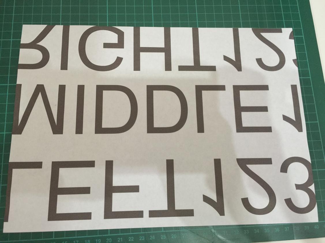

Seems that the issue is with Cyan ... but im not sure how im going to fix it ..

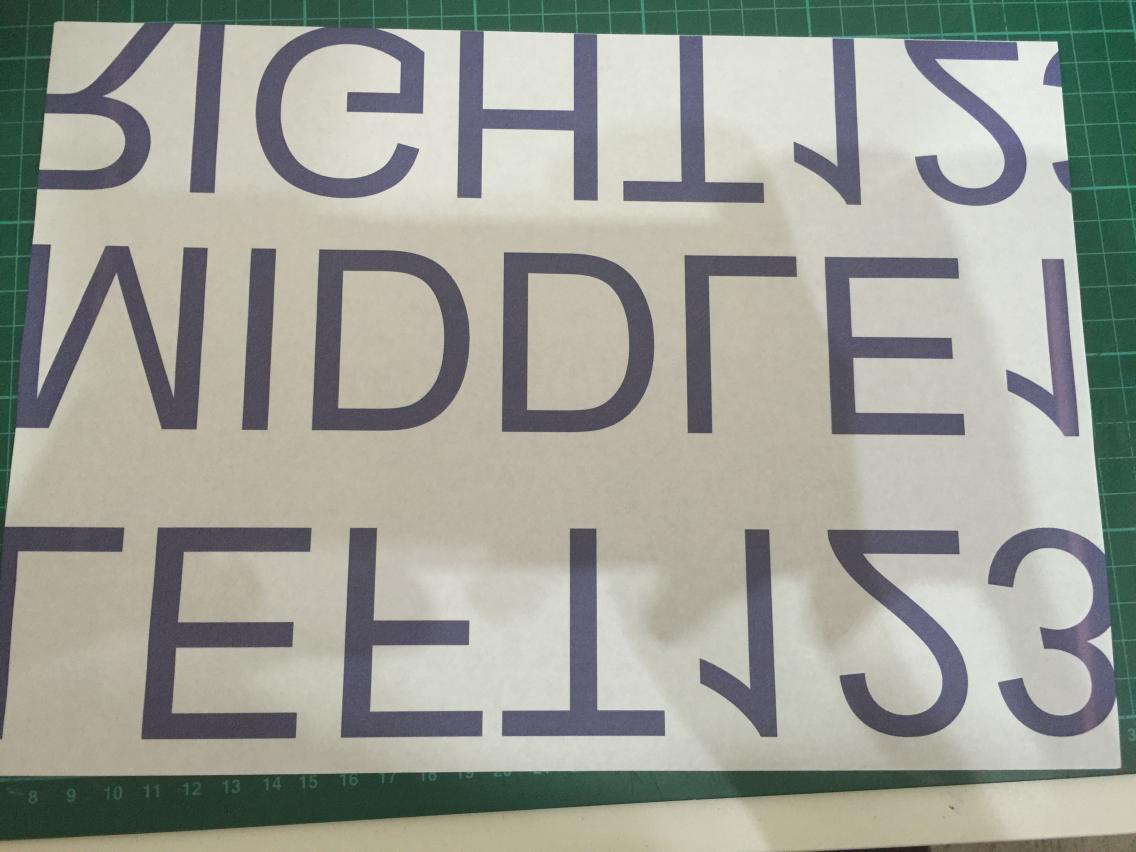

See these 2 pictures side by side .. black is fine, cyan has the bandings at the same point as the full colour print ...
Though it is fainter, but you can still see the lines on numbers 1 and 3..
So i guess until i get a full nozzle check on cyan i'm still gonna have this problem ..
Not sure what else I can do in trying to "clean the printhead" though ?
And if the nozzle check was to blame .. why am i only getting the problems at the front and end of the prints ? Why not anywhere else ?

What paper are you using? Is that line always in the same place on the paper? (Sorry if that's already been answered) Reason for asking, I had a batch of faulty paper that displayed a very similar result.
Re: Lines at beginning and end of full print ?
Does the same with sublimation paper and normal copier paper unfortunatelyJustin;102130 wrote:What paper are you using? Is that line always in the same place on the paper? (Sorry if that's already been answered) Reason for asking, I had a batch of faulty paper that displayed a very similar result.

I appear to have found the issue - I was printing borderless as i wanted to use them for A4 jigsaws so I had a slight bleed ...
Unticked borderless and prints appear to be coming out fine now - what a pain that was !
