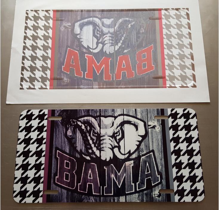

This is my first sublimation tag. What do I need to do different? The black houndstooth design and the vertical black/red stripes on the sides are vector. The image in the middle is a .jpeg copy/paste/imported. The black houndstooth is printed perfect both sides. Vertical stripes and image nowhere near perfect. Can anybody let me know what I need to change and do different. Thanks.
Printer: Epson WF-7610
CISS & ink: InkXpro
Transfer Paper: World-Paper
Sublimation Alum. Tag: SignWarehouse
HeatPress: Stahls Hotronix 16x20 swinger
Temp: 400
Time: 45 sec

It looks to me that the pressure may not be even. The houndstooth looks a great black and has been released well from the paper but the middle still looks as though it has not been pressed either for long enough or not enough pressure.
You also don't mention if you have an ICC profile for your set up.

No I do not have an ICC Profile. Where do I find the profile I need? The uneven pressure makes sense. Maybe changing to heavy pressure will do better. I would like to figure out my issue without wasting too substrates on test prints. I just started the sublimation thing. I've done vinyl graphics for years. Just trying out something new. I just printed a mouse pad and it came out perfect. It being thicker/softer and more pressure may have made that print work.
