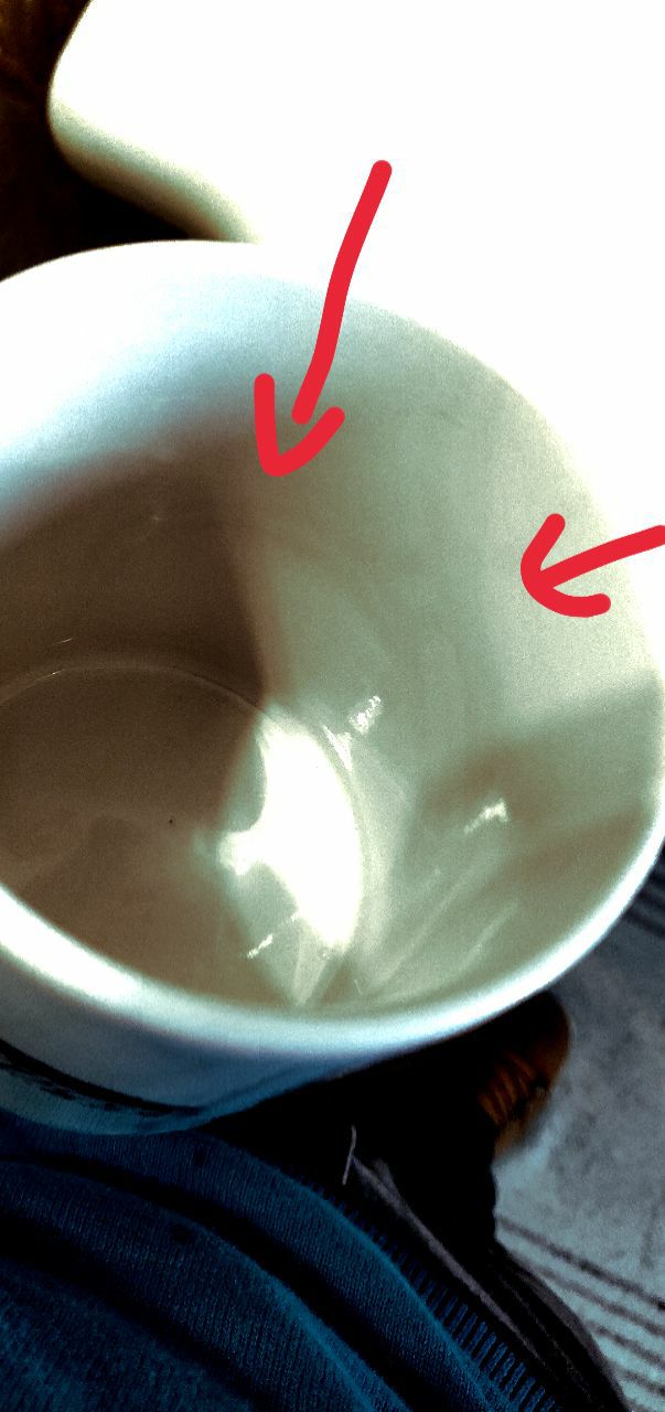

Hi everyone,
When I remove the mug from my press, I can hear a little crack sound. The mug stays intact but I can see some blue shadowed lines inside it. Again, no breaks, no visible cracks, just those lines. I'm attaching some photos.
Do you know if it's a weird behaviour and what could be causing it?

Re: Crack sound and blue lines inside mug
Which mugs are you using? What press/time/temp etc?

Hi Justin,
AA grade orca coated mugs, 200 °C 201 seconds, high pressure... Press is a Chinese multipress

Post by InkExperts »
Hi, temp is a bit high and time is a bit long in my opinion. I use Orca mugs at 175-180c for 180 seconds. Although I have never been able to crack a mug as such through increased temp / time. Only other thing I would suggest is to ensure the mug is warmed before inserting into the press, this reduces a sudden change in temperature which can cause hairline cracks.

.... And remember you don't need a very high pressure, as long as blanket is making good contact with mug all the way around, it should close with just a little force.

Post by Fletcher »
Those lines are cracks. Did you sort it? if so what was it?
as already said Warm the bottom of the mug before pressing, Try reducing the temp and time. I use a chinese 5 mug press, temp is 170c for 160 seconds.
