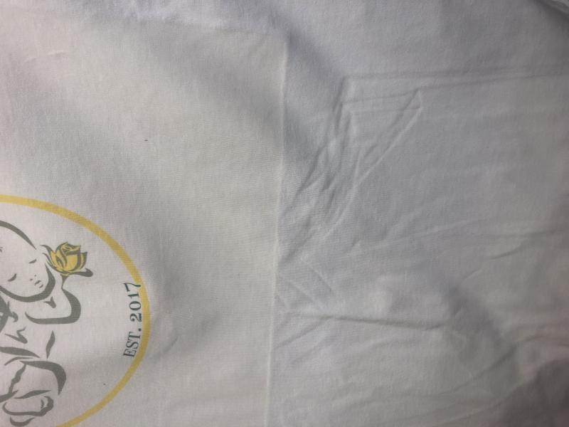

A look at how it is

Mrteajunkie
Posts: 1237
Joined: 13 Nov 2016, 21:59
Been thanked: 3 times
Re: Polyester Printing HELP!
Post by Mrteajunkie »
Is that printing a yellow tint to the paper?
So when you print does it print just the image and then spit the paper out.
Or does it continue for a while then spit the paper out?

Have you been printing hi-vis or bright coloured polyester?
Is your cover paper leaching something onto the fabric when pressed?
