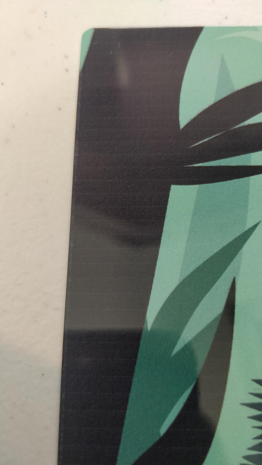

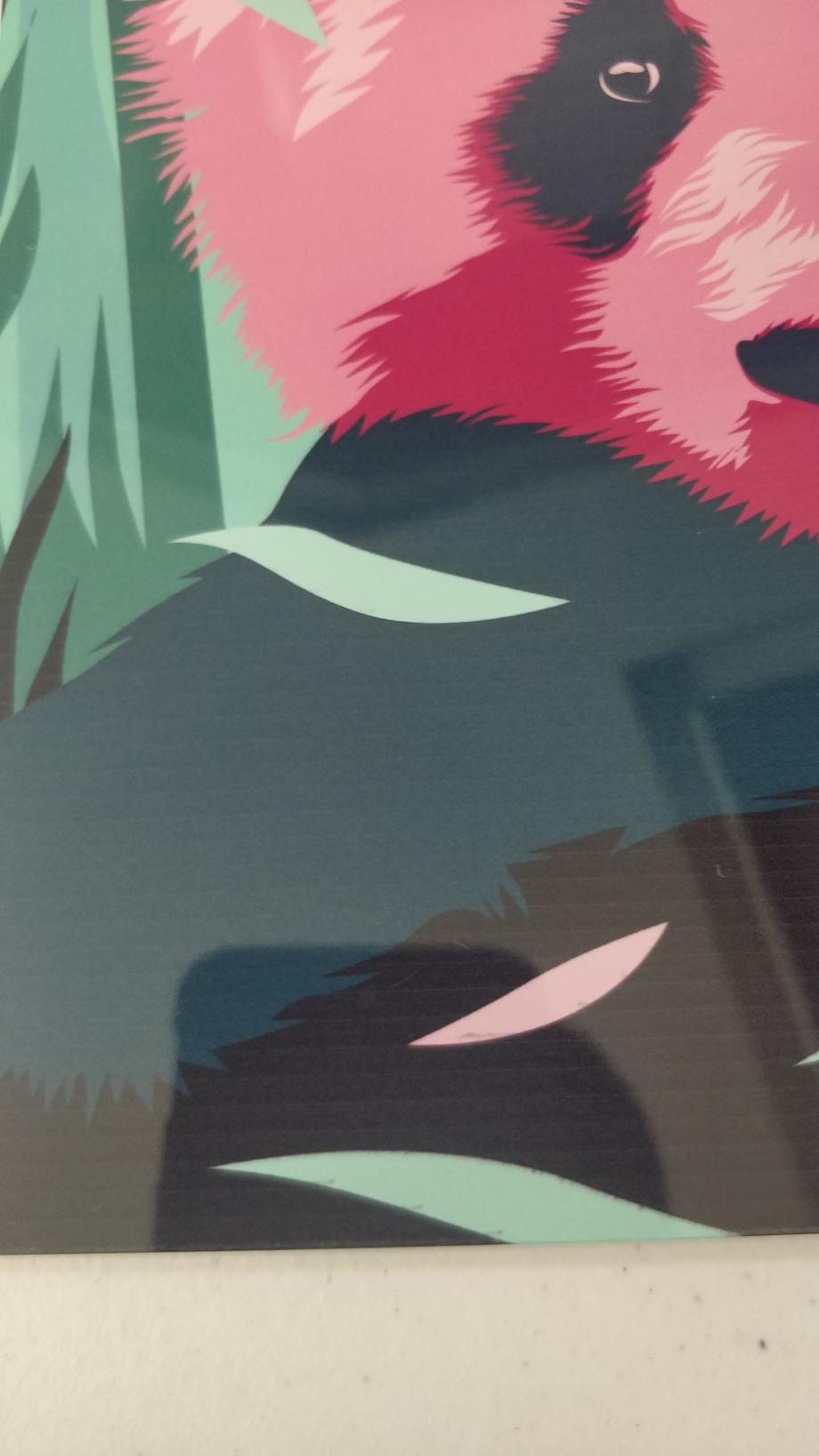

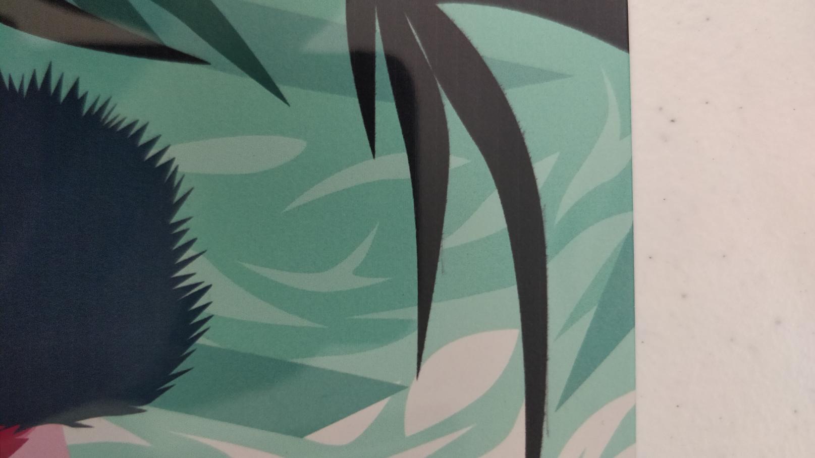

I'm new to sublimating metal sheets. Why are there horizontal lines when pressing? Is this from the printer settings? Also, I have been experiencing smudges particularly in dark colors. And there is a smudge on the 4 corners of the metal sheet I dont know where it comes from.
Settings are the ff:
Temp: 180 C
Time: 60-90
Epson Matte Color Settings
What are your comments/experiences with this and how to solve each one?

That looks like banding to me, caused by blocked nozzles. Can you upload a picture of a nozzle check?
What are the temps, times and pressures you are using when pressing?
Do you place your aluminium face-down on your print for pressing?
Do you use any layers of paper or kitchen roll underneath to help with any water vapour, which would produce smudging or marbling?

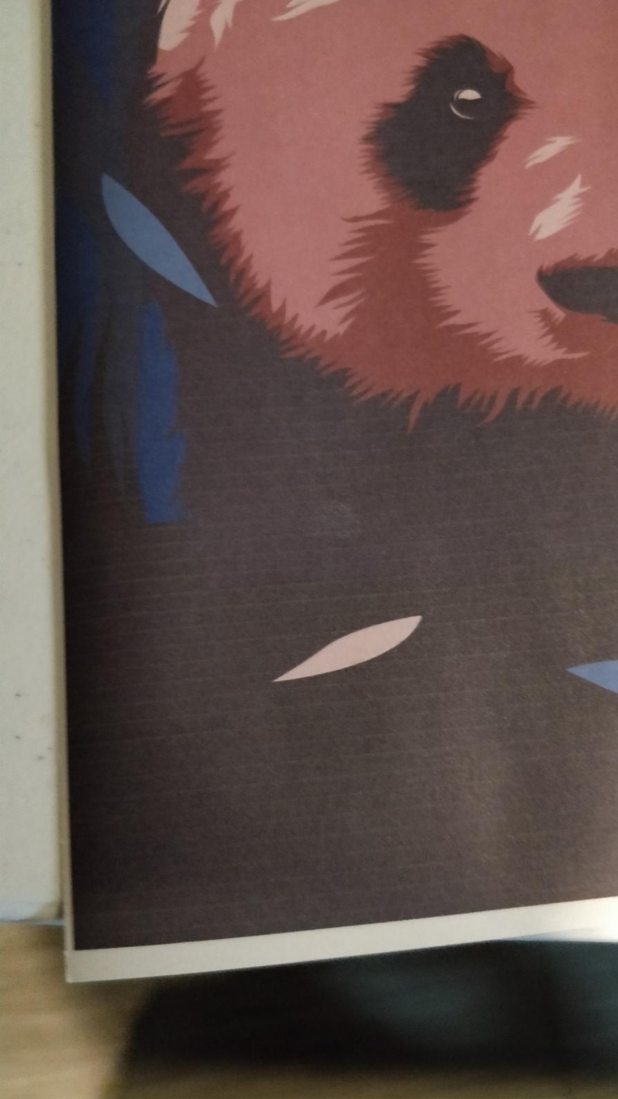

Here is a picture of my printout [ATTACH=CONFIG]5871[/ATTACH]

Your issues have nothing to do with printing on metal. You need to perform 3-4 head cleans until you get a decent print. Or do it once and leave the printer sitting overnight. Make sure that you have done a head alignment test and have your settings on 'Best Photo'.
Re: Aluminum Metal Sheets Printing Issue - Horizontal Lines and smudge on edges
Yeah, this is definitely banding caused by blocked nozzles.
