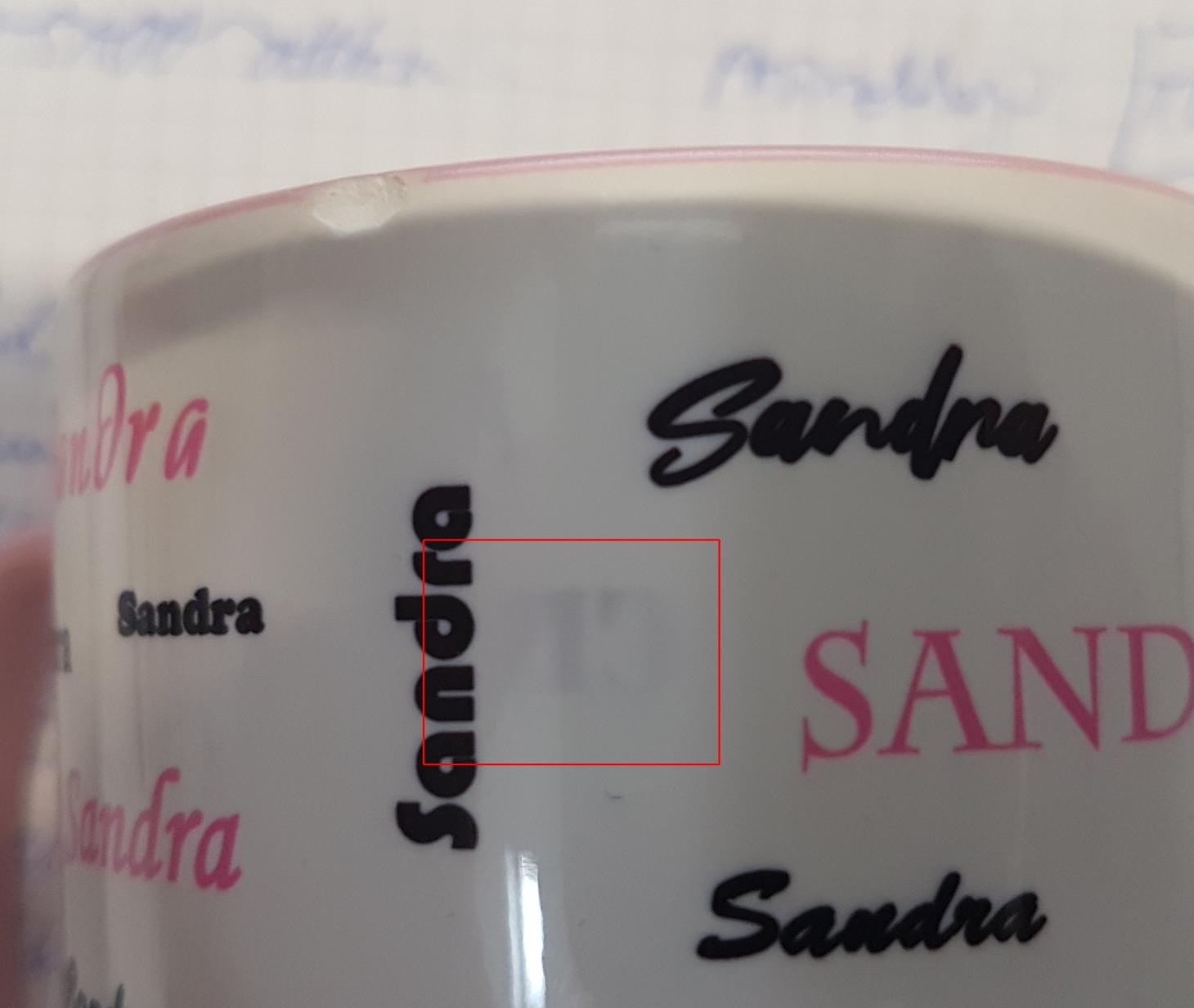

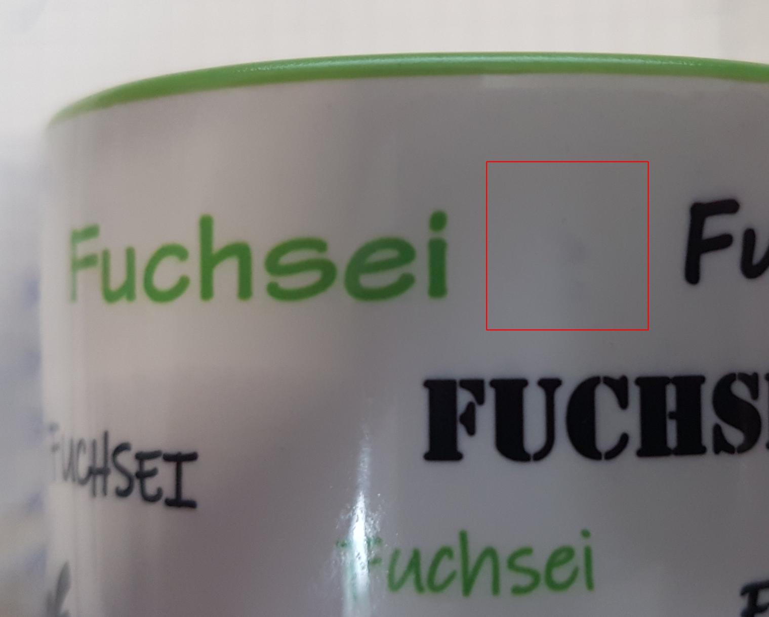

if we do a few mugs one after another there we can see some unwanted stuff printed on the mugs.
For example: we print two mugs with names on it - and after pressing the second one, there you can see some ghosting of the previous mug.
Here are two examples:
[ATTACH=CONFIG]6373[/ATTACH]
[ATTACH=CONFIG]6374[/ATTACH]
Hope you can see the problem.

I think that the ink passes the sublimation paper and then lays on the heating map and will then transfer onto the next mug.
Hope there are some experiences with this
