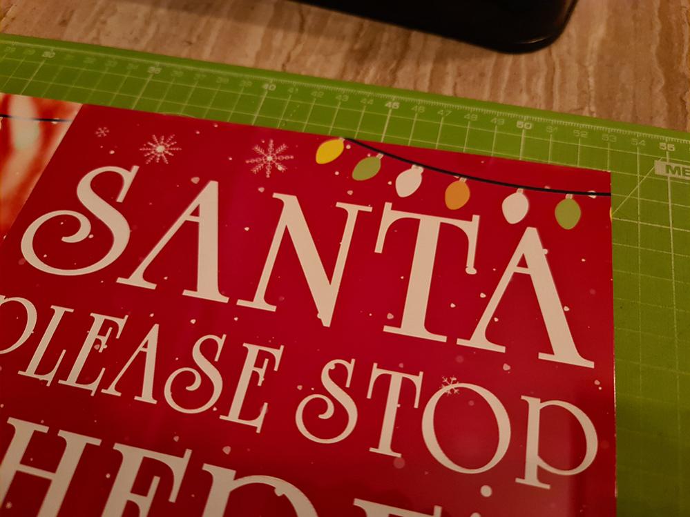

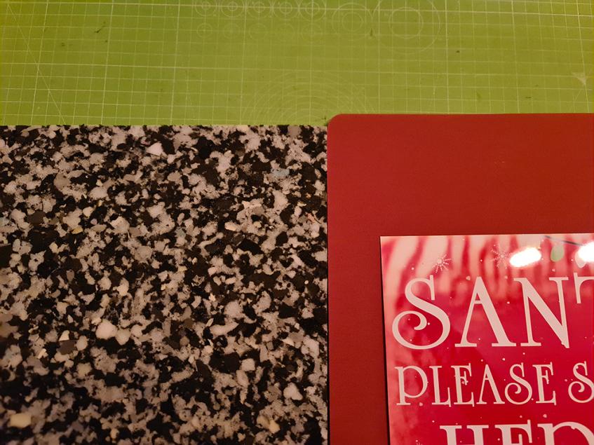

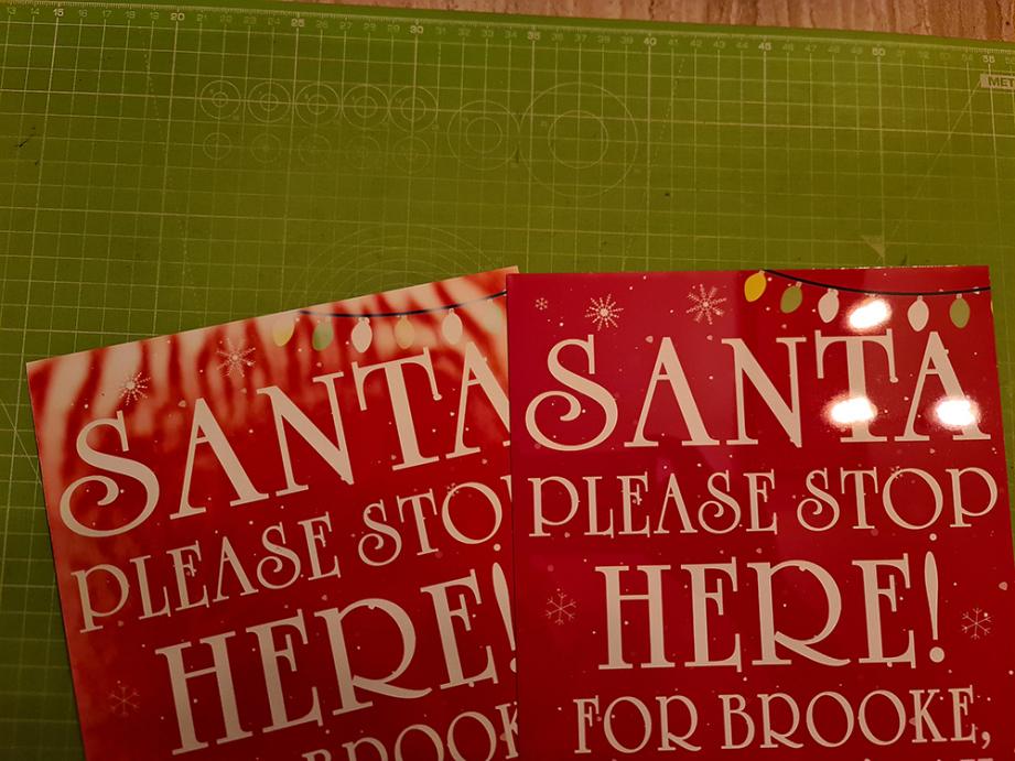

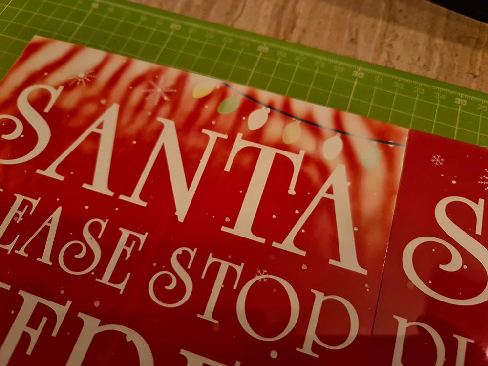

I'm having a bit of problem with sublimating these metal panels and wondering if anyone has had a similar problem.
If I use the orange silicone foam matt I get the weird clouding and it's as though there is either moisture or something wrong as if I use the matt that looks like underlay I can get a half decent sublimate.
It's like there is either moisture or the silicone matt is taking the heat away from the panel. I've left the foam on the radiator for a couple of days in case this is true but I've just done a test and it's the same.
Hope someone can shed some light on the problem. I've wasted all of the panels I had in stock so waiting for some more. I suppose I can use the underlay matt with silicone paper between but it's not ideal.

Re: Signzworld 0.5mm Aluminium Panel giving me grief
Are you pre pressing the metals?
The Mark's look like moisture problem .... they are where evaporating water (steam) is pushing out to escape.
Something you are putting in the press is damp, either the metal or your transfer
