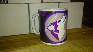

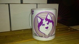

hi all im new so bear with me as I try and explain we were printing out a design on our printer and where it graduates from purple to black it prints the image wrong have posted the original image from our designer a nd a picture of the mug once printed and there is a distinct blue ring, do you think this is because of the FADE from purple to black and the printer can not pickup the colour change properly [ATTACH=CONFIG]1571[/ATTACH] [ATTACH=CONFIG]1572[/ATTACH]this the original art work next pics are what printed out[ATTACH=CONFIG]1573[/ATTACH] now the white one[ATTACH=CONFIG]1574[/ATTACH] as you can see the blue hue around the ring as I said do you think it due to the graduation from black to purple, we are only using a basic set up as we are only printing to generate income for a dog rescue center so any advice would be grateful graphics program is coraldraw x6 printer is a Epson sx130, ink is generic we were told by supplier of ink to use sawgrass d88 icc profile which is currently being used with no colour correction set on printer thanks fortaking the time to read spike

Have you set Corel up inn accordance with instructions on Sawgrass site? You might get somewhere close with the D88 profile if you're using Sawgrass inks. if you're using other inks (which we cannot support here) then the profile won't give you decent prints. You could get a profile created by Paul (mod on this forum) and a discount on the price by becoming a Premium Member.
Re: colour issue with printer
tell your supplier to bush his head against brick wall :) . sometimes and i repeat, sometimes other icc may work for someone but only just.
but if you would like to get colors as close as your setup will allow you then you need to buy supported setup from reputable supplier or get custom icc profile done for your setup. but in case of custom icc profile ou need to know what ink is in your printer so you can cary on with same ink. as new ink would mean new custom icc.
edit:
btw... this neon purple will not print exactly as on your screen. no matter what set up you got.
