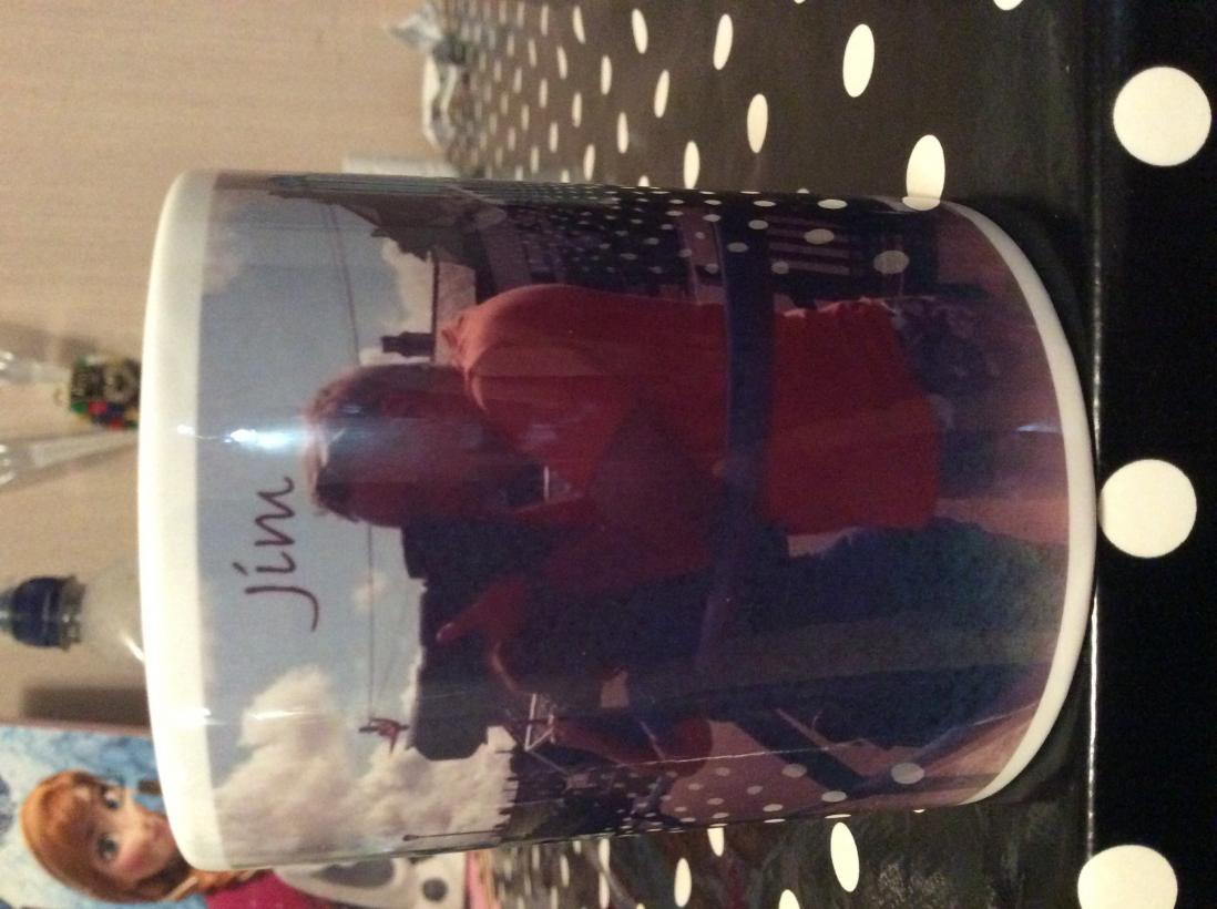

It is not very clear but this is the duff one

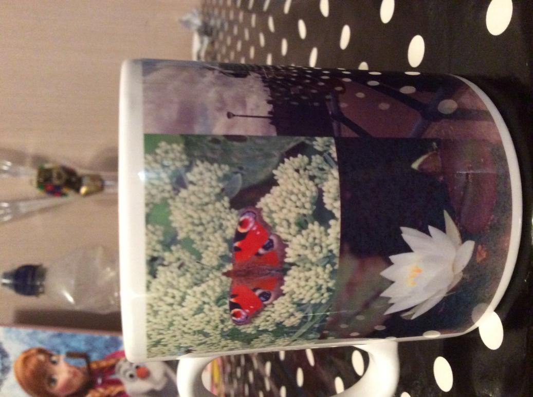

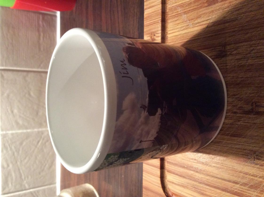

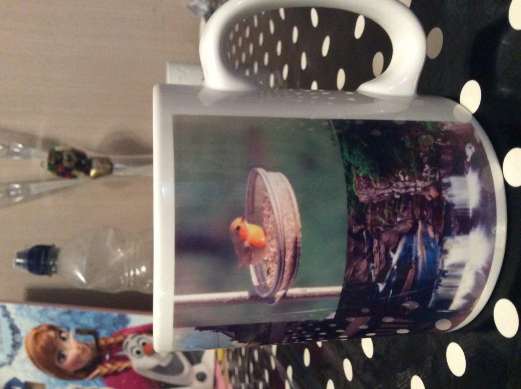

Here are some better photos

Re: Ricoh Aficio SG 3110DNw bad quality photo on mug.
When we do photo mugs or artwork with high surface areas of flat colours then we have to change temperature and duration when pressing. Usual mug (normal graphics) we do at 170c and 140s but photo mugs we do at 180c and 180s. Olly
Hi Tracy. I read you have a Ricoh so to be honest I wouldn't go above 180c which was the max temp suggested by BMS to us. At 180c and 180s then I would say this is fine. The only other suggestions I personally have would be your paper type (are you using TruPix or the BMS pre-cut mug paper as these are the best in my opinion), are you using quality mugs (again the BMS European RN coated mugs are the best we have used and we have tried lots!) and to make sure your mug press wrap isn't past its end of life. The plug-in wraps do need changing apparently every 500 mugs or so. If after checking you think there still is a problem, email me your artwork and I will put it through our process and we will see if we get the same issue. Olly

Post by arthur.daley »
have to say that those mugs look just like ones that could do with getting the bottom of the mug much warmer before they go in the press. I have had the same problem and preheat has always cured it.
