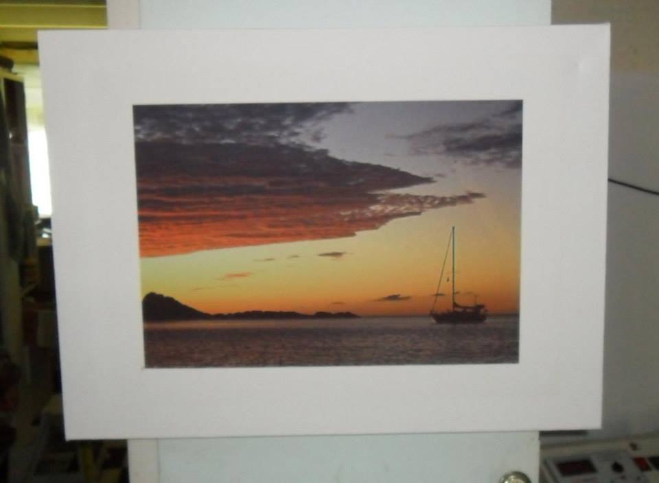

Here's another A3 wall hanging from my early jobs. Now I cut the ends of the hanger even with the canvas.
Here's one using Dye Sublimation. A3 print onto a pre-stretched canvas. The canvas has to be treated with a polyester coating first for this to work and be permanent. These are expensive, but popular with customers. So basically, there is no framing and stretching to do. Just treat the canvas, then apply the sublimated print just as if you were printing a shirt.

By the way, they are only blurry because I'm using really low resolution images to post on the forum.
