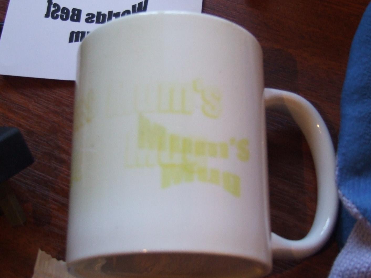

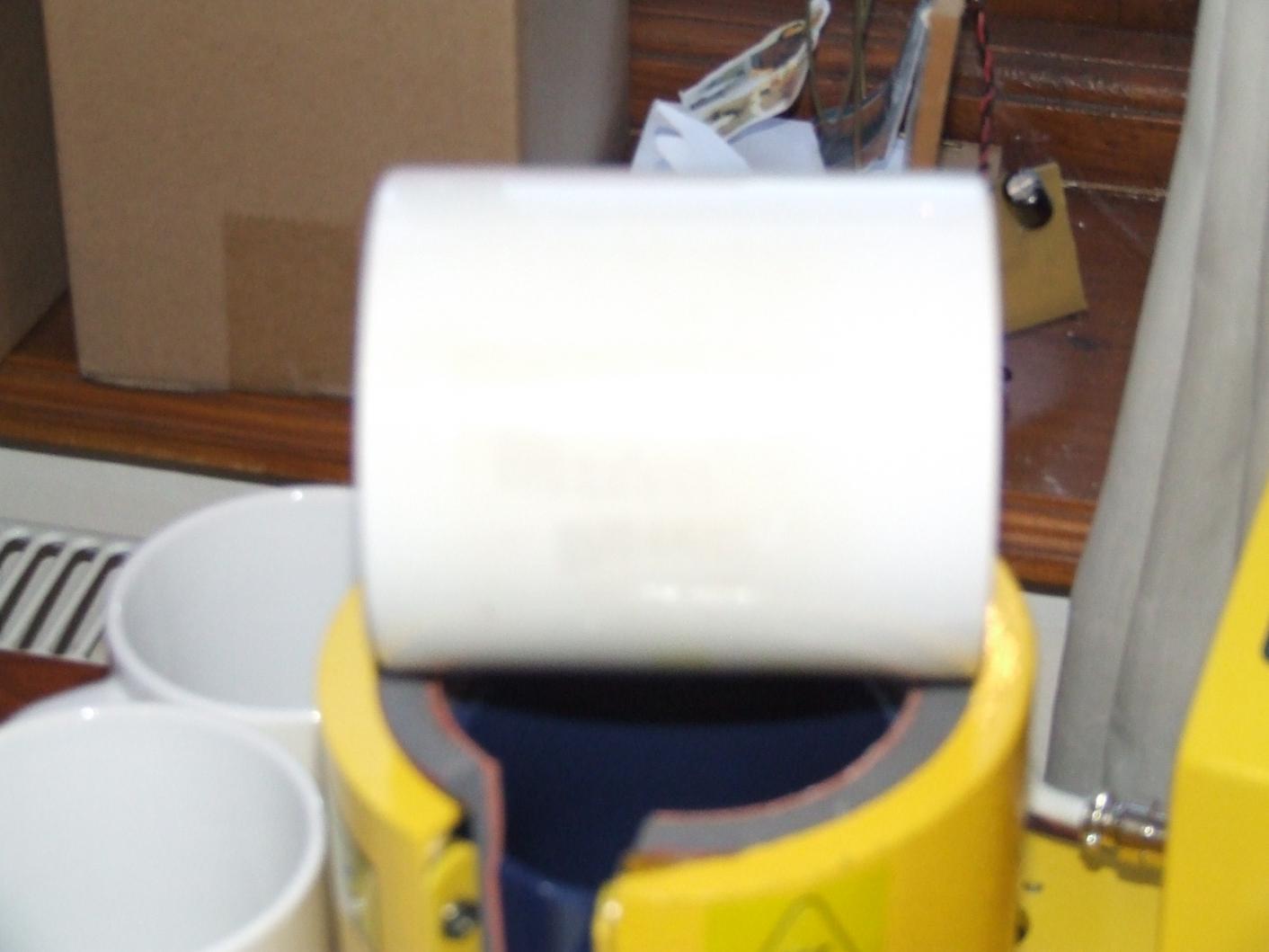

can you post a picture of a mug that you've tried to sublimate?

the second one came out a little black as selected to print in black
galerion;100265 wrote:can you post a picture of a mug that you've tried to sublimate?

Although you will need a ICC or Powerdriver from that pic I would say the ink isn't sublimation ink, has your printer had regular ink in it at any point in its life?
