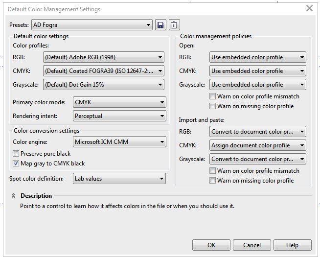

I'm not aware of problems exporting files although certainly some users experienced colour issues with earlier versions. The colour management was completely revamped for X5 and onwards, doing away with the sometimes confusing graphical chart with all the arrows and it should be more accurate now but like everything else that changes there is a learning curve.
I send alot a files away to trade houses for litho and digital output primarily using pdf X1a and don't have an issue, I always use cmyk colour model to work in and the colours of the jobs that come back are fine but I appreciate that if you had fine tuned your output in X4 to your own device it may have been slightly different in later versions but you would have experienced the same I think with other software packages.
FYI here are the settings I use
vB_ID:3484
vB_ID:3484
colour settings.JPG (76.66 KiB) Viewed 535 times
Publish to pdf has its own setting regarding how colour and fonts are handled but using the default pdfx1a and then fine tuning and saving is the way I go and I've not been let down yet (I'm now crossing everything I have 2 of!!)
