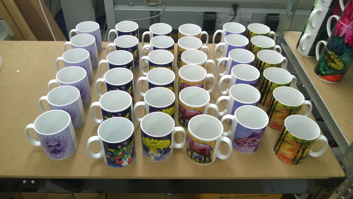

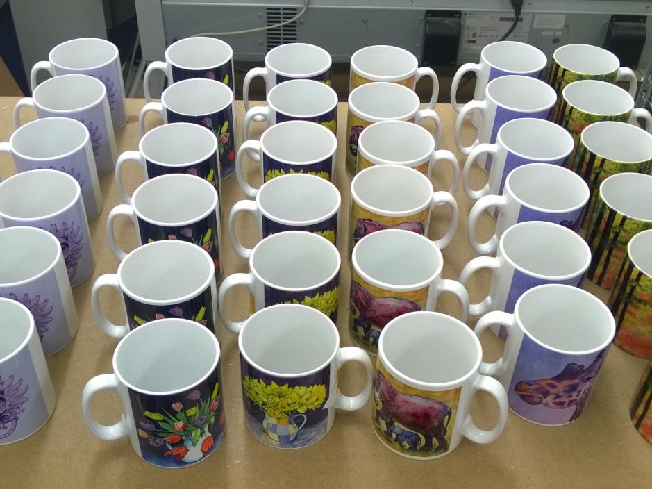

Did our first run of 36 for another designer (not even our own work got to go first!) who's also based at the arts centre we set up in town. Very pleased with the results, colours strong and vibrant and even right to the edges and top/bottom.
Set oven to 200 not got a thermometer to check what temp it actually is yet, leaving in for 10 minutes had a few patches on the mugs not print correctly, so next load I did for 12 minutes and they were spot on.
So, need to buy oven thermometer, preferably digital, and a countdown timer thingy.
