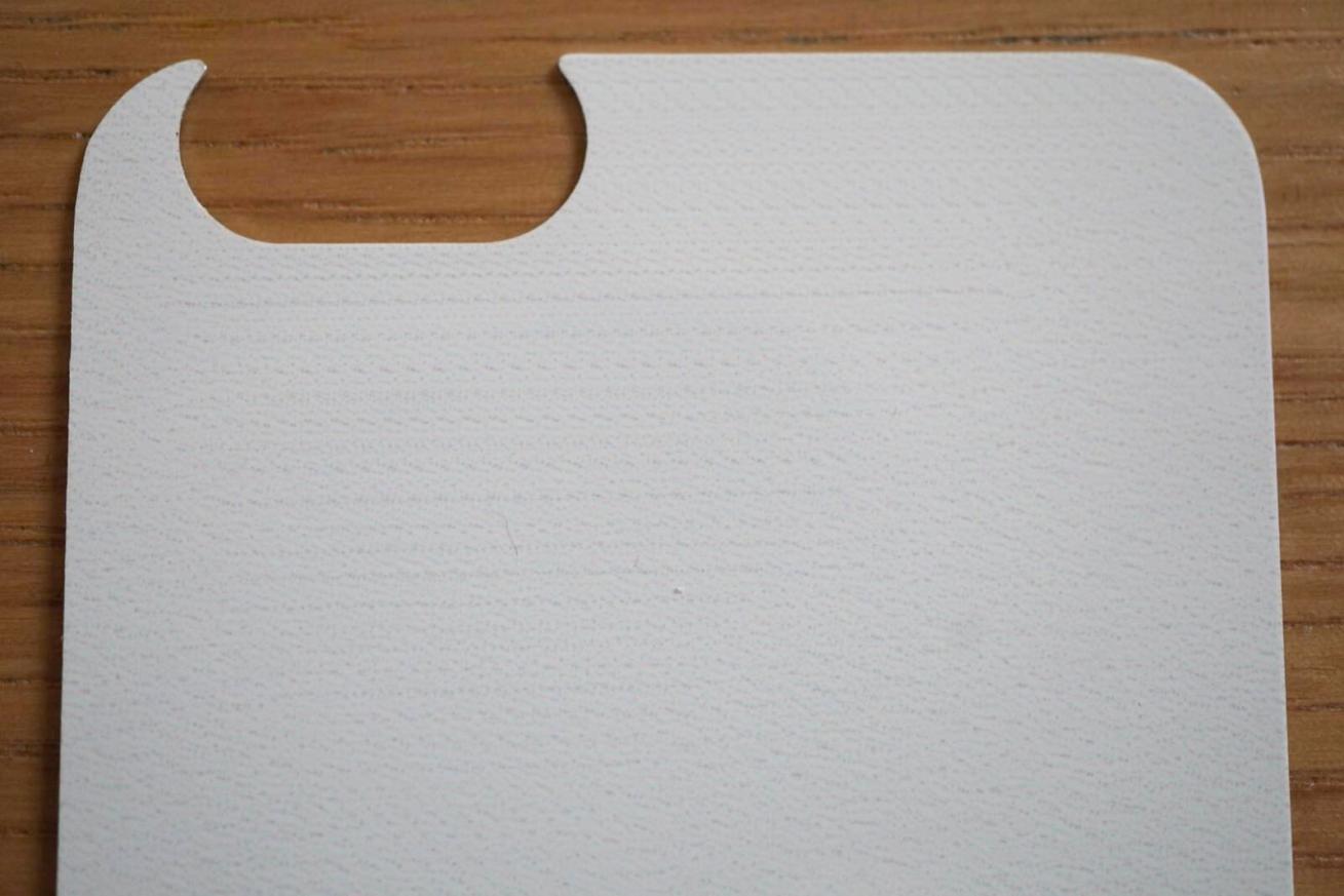

With my sg400 the dots appear on light colours and are more noticeable on flat areas of light colour. I printed of an image of one solid beige colour in photoshop and heat pressed it onto a metal insert.
You can see the dots on the printed paper but they become more apparent once you've activated the ink with heat pressing. I've also used different types of paper, trupix and xpres with the same results.
I've seen these dots occur in two separate sg400's. Is this an actual fault with the printer or is this to be the expected quality of the prints from a 4 colour printer?
I've used an epson 1500w in the past and never had this problem which is a 6 colour photo printer.

Yeah that's why I just ordered the Epson 1500W. Just wasted €420 in this Sawgrass. Damn why people keep saying it's a great printer ? I acknowledge it's got a very fine quality but light colors literally suck!! You just can't afford to use it for commercial ends.. or your clients are cheap as hell
Re: [Need feedback]Epson Artisan 1430/1500W
I would of said that possibly you have an issue with your print head. We have a range of Sawgrass printers and churn out light solid colours all day long for mugs, coasters, placemats and keyrings. All without fault and with PowerDriver v4 then things are even better. Not what you want to hear of course but I would return printer and get it exchanged. Cannot fault our printers.

UK Printed Mugs;110246 wrote:I would of said that possibly you have an issue with your print head. We have a range of Sawgrass printers and churn out light solid colours all day long for mugs, coasters, placemats and keyrings. All without fault and with PowerDriver v4 then things are even better. Not what you want to hear of course but I would return printer and get it exchanged. Cannot fault our printers.
I've emailed the supplier to see if they know if there is an issue with the printer. Do you own a sg400? I wonder if the ricoh sg3110 has this problem.
