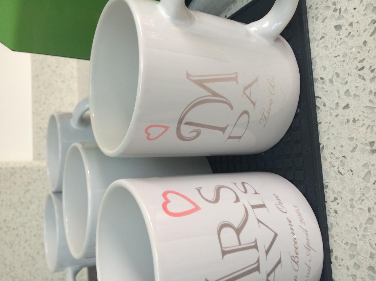

Print not transferring to mugs
Re: Print not transferring to mugs

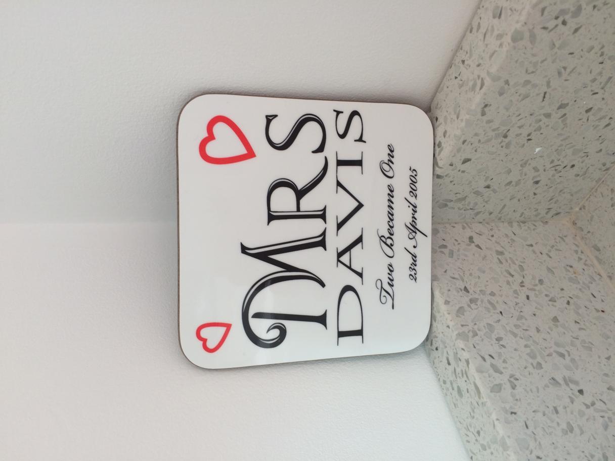

That's the print prior to sublimating and it pretty much looks the same once sublimated. This is the coaster I did with the same printer.

Sorry not sure why the photos are all rotated to the left. Also even after 320 seconds, the plain piece of paper round the outside of the mug was not brown in any places. The handle was still pretty cold to touch.
Go to calibration option and about 15c and see if it helps. If it will be better than you can add bit more.
Handles won't get hot unless you're using an oven of course. Either mug press isn't reaching temperature it says it is or mug coating is terrible. I personally would say press.
bfos
Posts: 37
Joined: 21 May 2016, 19:11
Post by bfos »
Paul ive changed the calibration to -15 degrees and it's worked a lot better. Pressed at 180 for 320 seconds. Faded slightly at the bottom but I have read that warming the base for 15 seconds could help that? Maybe I'll change it to -20. This time when I put the mug in the temp dropped to 170 whereas it didn't before so definitely something to do with that. It looked like it had been preset to +50 when I entered into the menu, not sure why, though default would have been zero. The paper even browned a bit too so definitely was an issue with the temperature. I will keep trying, thanks again.
