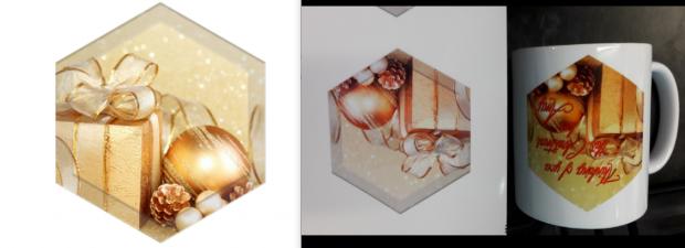

This image below is showing LEFT - screen shot from Photoshop - MIDDLE - camera shot of photo from EPSON 1500W RIGHT Sublimation on MUG from new Epson 1500W
Firstly the MIDDLE Camera shot isnt brilliant it looks pretty much the same as the screenshot to the normal eye - the camera has distorted this.
However, you can see the massive difference in contrast and colouring to the Mug Sublimation.

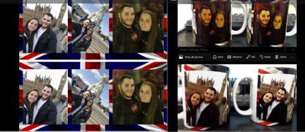

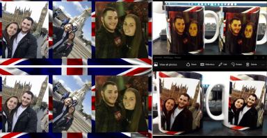

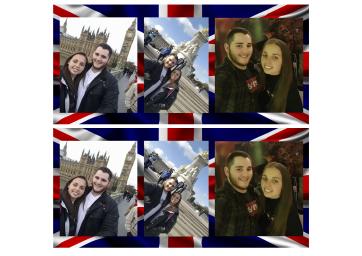

Then there is this picture below again showing the Photoshop screen capture on the left, and then the mugs on the right ... The top mug with the ICC provided and the Bottom Mug, with a slight tweak on Printer settings
I understand there will maybe fine tuning from an ICC, but this just looks drastically out!
