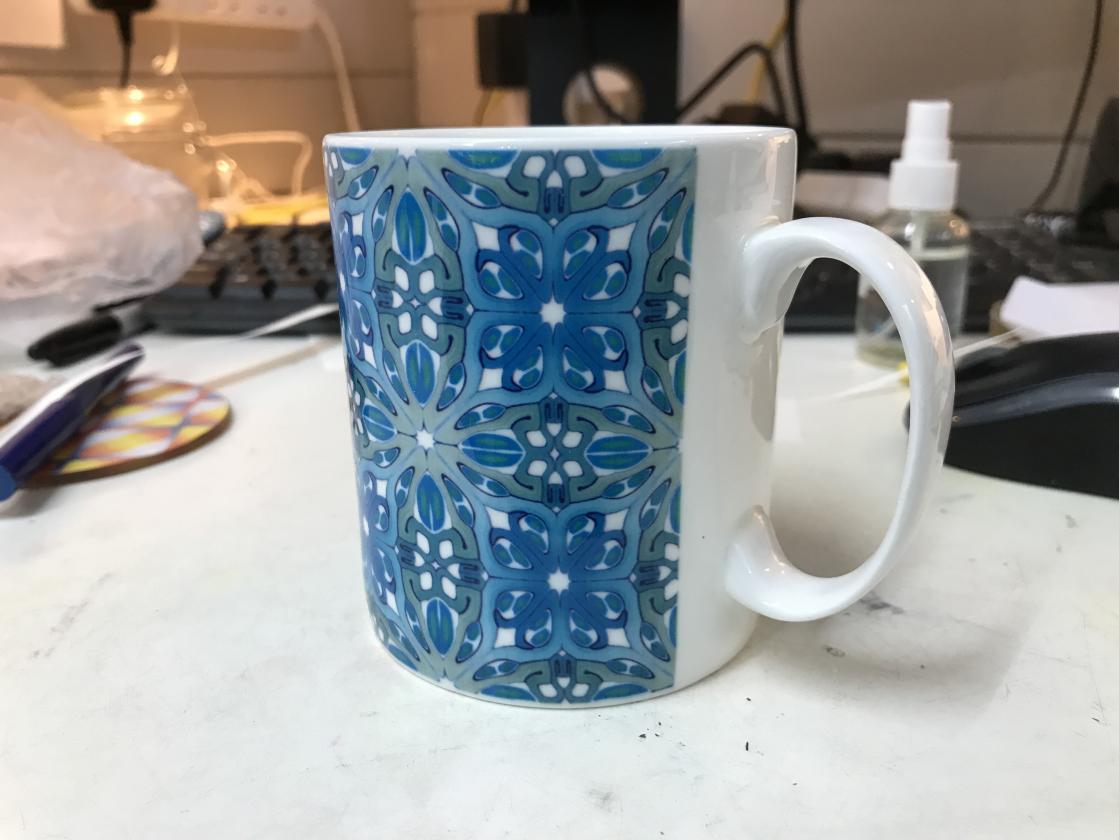

by RuthWinchester
vB_ID:4940
vB_ID:4940
I think this is about as close as I personally can get to the handle and the top and bottom without running the risk of a blurry section of print or a little escaping bit of colour somewhere you don't want it. Hope this helps... good luck!

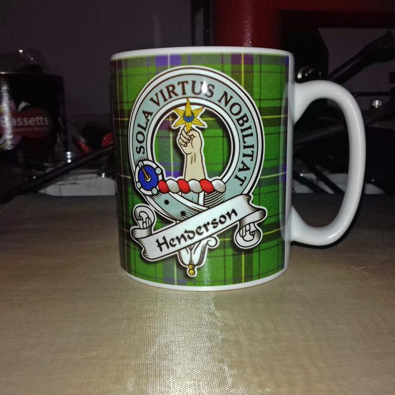

Just received my halogen oven today from The Transfer Press and first attempt is looking good. Temp 180 C, time 15 mins with only one mug in the oven. Mug is a Listawood 10oz Duraglaze AAA. CIE inks and paper. Ricoh 3110 print. I need to do a bit more experimenting though ...
(PS. The actual mug looks much better than the picture. The white areas in the design are actually pure white, whereas they have a bluish cast in my picture. I'm not great at taking photos! :wink: ).

Looks great to me! But 15 minutes? Blimey, that's long - I'm doing 190 for 9 mins for a single bone china, and 10 mins at 200 for a single ceramic... with 12 mins for two. But then my oven temp is often over 200 (oven thermometer) even though the dial is set to 190...

RuthWinchester;128377 wrote:Looks great to me! But 15 minutes? Blimey, that's long - I'm doing 190 for 9 mins for a single bone china, and 10 mins at 200 for a single ceramic... with 12 mins for two. But then my oven temp is often over 200 (oven thermometer) even though the dial is set to 190...
I'll probably be able to whittle that time down, as I said, this was my first attempt with a halogen oven and I wanted to start at the high end to make sure I got good sublimation without fading.
