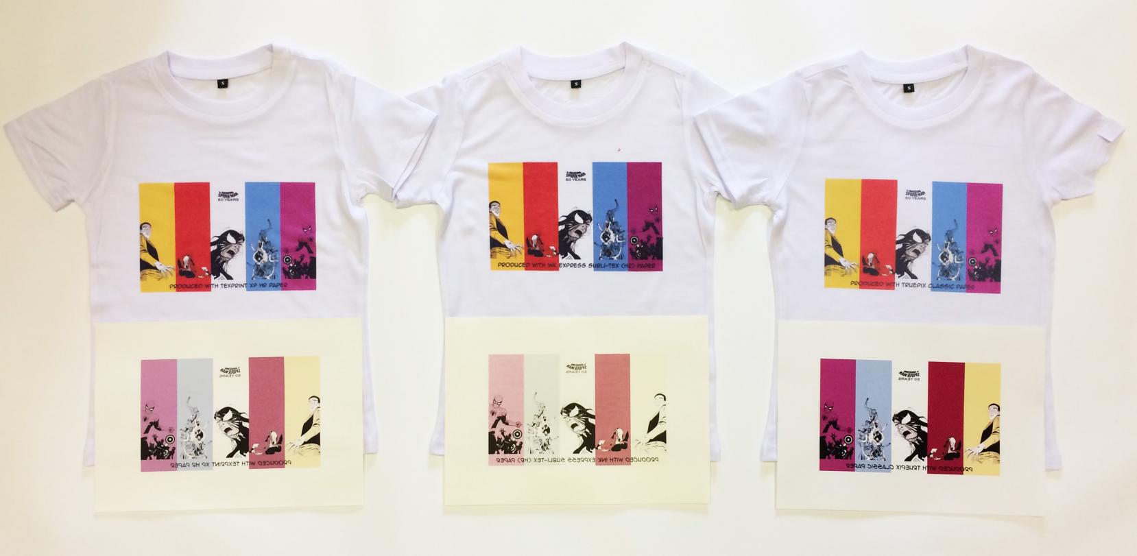

marzy;133009 wrote:Yes sublimation inks, the official sawgrass inks from when I first bought the printer.
im using try pix paper and yes printing in the correct side.
I would guess it is the paper. Although it is a good paper; Trupix Classic is not high release paper and performs very similar to our Subli-Sharp paper.
I tested Trupix against my Subli-TEXTILE paper-
Left is TexPrint XP HR
Middle is Subli-TEXTILE
Right is Trupix Classic

XPHR is a great paper, it was the best High Release I could find when I was trying to source our own. Our paper releases a touch more ink but not a major amount, but I felt paper handling was a little better on our paper (it did not curl as easily when placed under the press and also did not get marked by the paper rollers when printing)
