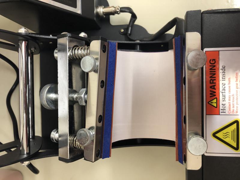

Hi there!
I know this is an old thread but I was scrolling trying to find help with the MDP mug press I just started using (previously used an oven and this is my first mug press) and you seem to be pretty experienced with it so I was hoping you might be able to help on the off chance you might see this : )
I have been doing some pressing today with not a lot of luck so far, but I'm not quite sure where I'm going wrong. I use the ceramic camper mugs with the lip on from MDP and presumed I should be leaving the lip outside of the press, however the font is very faded at the top of the mug. The rest of the mug is coming out slightly blurry and just not crisp.
MDP suggest 190 for 60 seconds when the press has hit the right temp but that seems to be way to short a time.
I have tried your suggestion of 180 for 200seconds, and even gone up in stages to 200 for 190 seconds and I'm still getting blurry images with fading at the top.
I noticed that you said when your press reaches the temp set it beeps but mine doesn't do that for some reason, so I have just been waiting for it to show it on the screen and then putting it in.
I just wanted to see if I could find any advice at all before I blow through anymore mugs.

Have you tried applying more pressure?
otherwise the blanket may not be reaching the top of the mug.
i use 180c and 180seconds And wait for the press to reach temp then insert mug and close.

[ATTACH=CONFIG]6287[/ATTACH]I only tried increasing it slightly because I was worried about it being too tight. When I close the press around a mug one of the springs slides open and the clamp doesn't close straight but more conical like in a latte shape (it's definitely the right element though) I thought it might have been that the screws were too loose so I tightened them but it didn't make a difference
