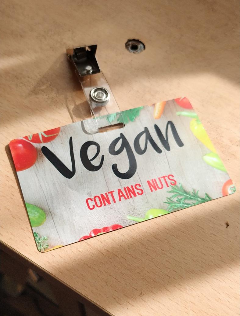

Would one of you be kind enough to post an image of a pressed card?
I thought about making some myself but my experience with the thin plastics wasn’t great.

Mrteajunkie;152198 wrote:Would one of you be kind enough to post an image of a pressed card?
[ATTACH=CONFIG]7134[/ATTACH]
This is one of the 0.2mm flexi ones we had a play with - available from TTP (https://www.thetransferpress.co.uk/plas ... 2x32864199).
No subbed 760mic cards to photograph...yet
[ATTACH=CONFIG]7135[/ATTACH]
Good vibrant prints...and no need to weight down after pressing either.
No subbed 760mic (credit card thickness) cards to photograph...yet
