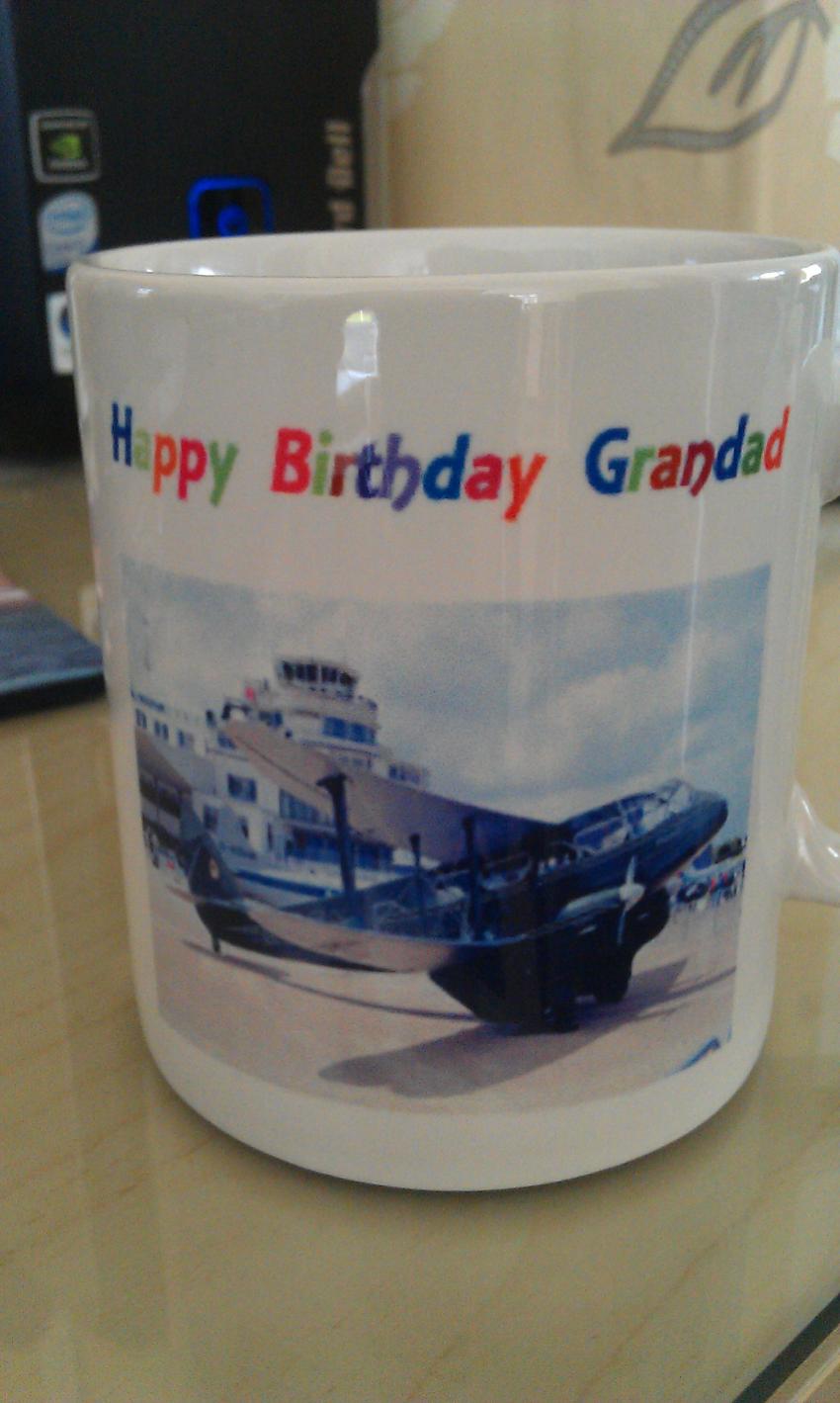

Update,
Ok Amazon did a good job and delivered the printer a couple of days ago:smile:
So I got to work and printed off a sample.
I was happy with the colours as they were damn close to the original photos.
however the text and the quality of the print was not so good, it looked very "1980's dot matrix" if you get my drift
just to clarify what setup I'm using......Artanium (Visi-sub) ink in cartridges. PS3 with ICC profile from Sawgrass. BMS mugs and Trupix paper.
Epson B1100 printer and the original press from love cut.
Presiing with medium to heavy pressure at 180 deg for 180 secs.
I am preheating the mug without transfer on and then putting it into the press for the full 180 @ 180.
I have included a couple of "mug shots"
Your thoughts are welcome
Neil

Are you printing on the whiter side of the paper? Images look over blue to me.What graphics software are you using and have you double checked all settings for printer and profile settings?Are you getting a perfect nozzle check pattern?

Yep definitely printing on the whiter side, I'm using the ICC profile from Sawgrass. It maybe the actual page setup that I have wrong i selected plain but after reading a few threads on here should I select matte and best photo? Next time I print if I haven't had any pointers I will screenshot my settings
Re: Ready to start mug smashing!
best matt for trupix and photo. not best photo.
also you can download other icc for artanium inks here you can try that.

I'm wonder if you have followed all the set up instructions? The reason fir this is that the printer set up instruction specify settings should be for photo not best photo;http://sawgrasseurope.indigofiles.com/t ... tion.pdfIs you nozzle pattern perfect?

The photo has also to be really good - at least 300 pixels per inch - a small poor quality photo will not work
Squadron Prints;25772 wrote:The photo has also to be really good - at least 300 pixels per inch - a small poor quality photo will not work
this is actualy not true ;)
I can print 72dpi with fantastic results. 300dpi is great when you printing wallpaper :P
