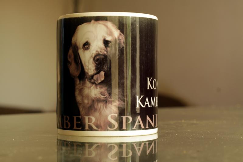

Si, if you let your press come up to temp with no mug in the blanket, you're gonna burn the crap out of it in no time! Also, the times I gave you are spot on for the Sublijet inks, when you have the profile sorted you should see improvements. Cook too long and too hot your blacks will turn a dirty brown. The last thing to consider is whether your press is actually heating to the temp it says it is. I'd suggest a infra-red thermometer to check it's actually hot enough in the first place.

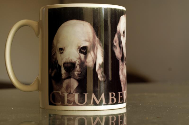

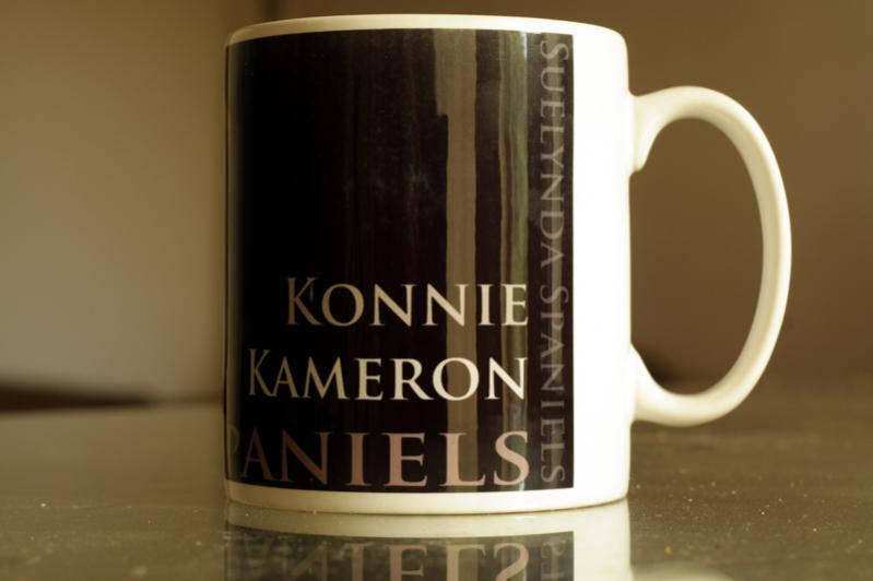

Heres the pics :
[ATTACH=CONFIG]582[/ATTACH][ATTACH=CONFIG]583[/ATTACH][ATTACH=CONFIG]584[/ATTACH]

Scotty@BMS;31661 wrote:Si, if you let your press come up to temp with no mug in the blanket, you're gonna burn the crap out of it in no time! Also, the times I gave you are spot on for the Sublijet inks, when you have the profile sorted you should see improvements. Cook too long and too hot your blacks will turn a dirty brown. The last thing to consider is whether your press is actually heating to the temp it says it is. I'd suggest a infra-red thermometer to check it's actually hot enough in the first place.
So are we meant to put the mug in when we turn the machine on?
What is the full process you use start to finish?

but you need colour profile :) I can tell... picture on te mug is sooo diferent then oryginal one. or is it just the bad photo???

Paul;31672 wrote:but you need colour profile :) I can tell... picture on te mug is sooo diferent then oryginal one. or is it just the bad photo???
The photo is very warm, taken in natural light, long exposure and wrong whitebalance setting...lol
In reality the images is pretty good, could just do with the black being blacker. Although I expected that with a B&W picture. Im waiting for the colour profile before we try a colour photo as i think that may be a whole different story.
Although I could probably improve the colour settings in Photoshop its on RBG1998 at the moment, when printing it lets the colour management in the printer decide colours.

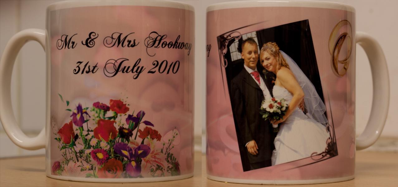

3rd time lucky!
Tried a colour image/design this time and it looks sweet as....
[ATTACH=CONFIG]587[/ATTACH]
This time, preheated with a mug in the machine to 180d, then swapped mugs and pressed for 160s followed by dunking in luke warm water.
(the photo of the happy couple is sharper than shown in the photo)
