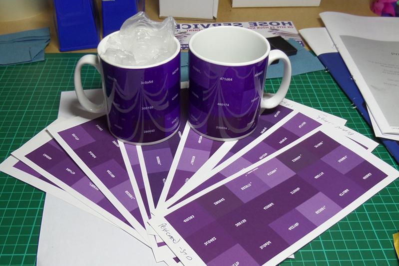

I have spent a week now trying to perfect a 'Purple' so any help would be appreciated
[ATTACH=CONFIG]2688[/ATTACH]

To be honest Nik, we never quite got round to it...that particular job wasn't that important that it matched 100% as it was for ourselves, so as it was busy I just left it and decided to get a profile done from Paul when I could. That was Christmas and of course, I still haven't gotten around to it...but it's still on the list!! :rolleyes:NikGrey;87272 wrote:I have spent a week now trying to perfect a 'Purple' so any help would be appreciated

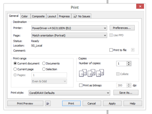

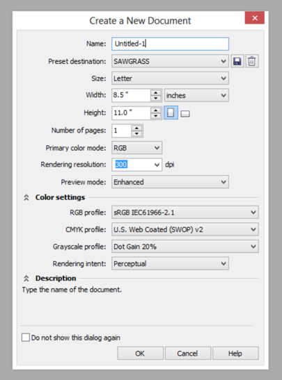

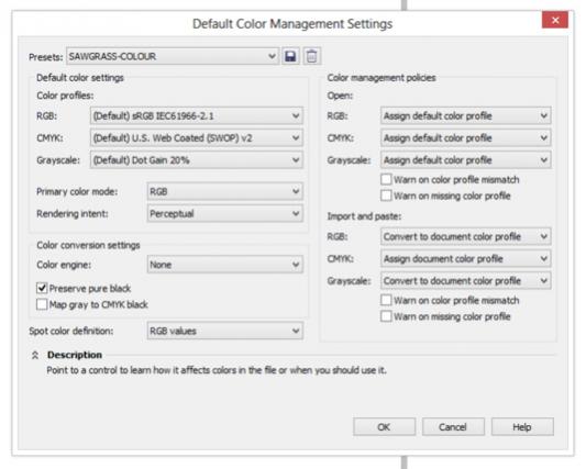

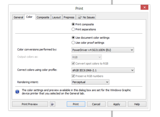

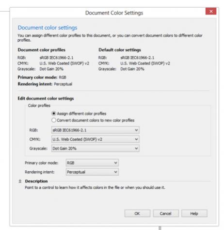

I'm getting really confused now, I have received a call from supplier telling to check powerdriver settigns, I have done this several times only thing I notice in the sawgrass guides it refers to "powerdriver-v4 sg3110dn (US)" but when I select powerdriver in print menu I have "powerdriver-v4 sg3110dn (EU)" is there a difference between US and EU setup?Justin;87258 wrote:The Powerdriver should be taking care of all of this. You're paying a premium for 'supported' inks that should work out of the box providing you have the icc profile/powerdriver installed etc.
I really don't think it's a satisfactory answer either and would be talking to my supplier as well.
Also they have said uninstall powerdriver and use icc I am wary about doing this as I have wasted enough ink and paper as it is, and like Justin said we are paying a premium for the inks and I was under the impression that why I have to download powerdriver etc
so why do things not work correctly and supplier says one thing and sawgrass says another.
I'm getting fed up now and just wish I stuck with my epsons I never had any problems with them
I've attached screenshots of how mine is setup according to sawgrass guides could somebody cast a second pair of eyes over these just make sure I haven't missed anything.
If I have to change to icc will this make any difference

I dont think icc installed should make any difference i thought powerdriver use same icc file just adding the interface?
Re: Ricoh SG3110DN colour issue
this why i'm getting confused, should I have downloaded an icc file as well as the powerdriver.
all I downloaded was the Powerdriver V4
