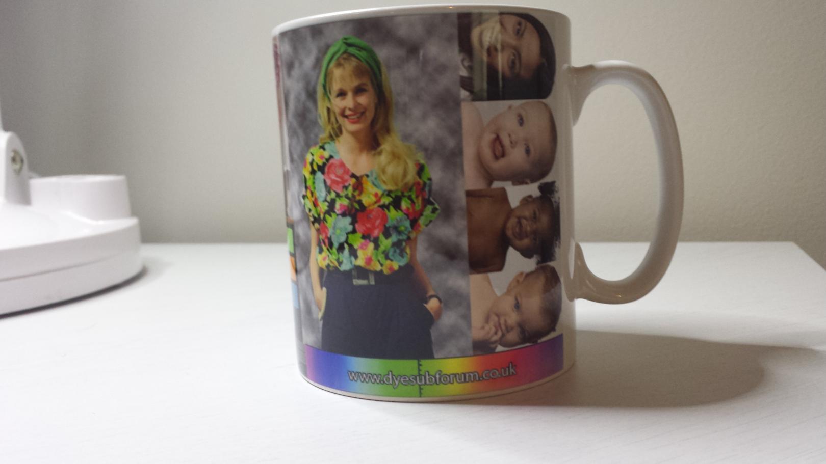

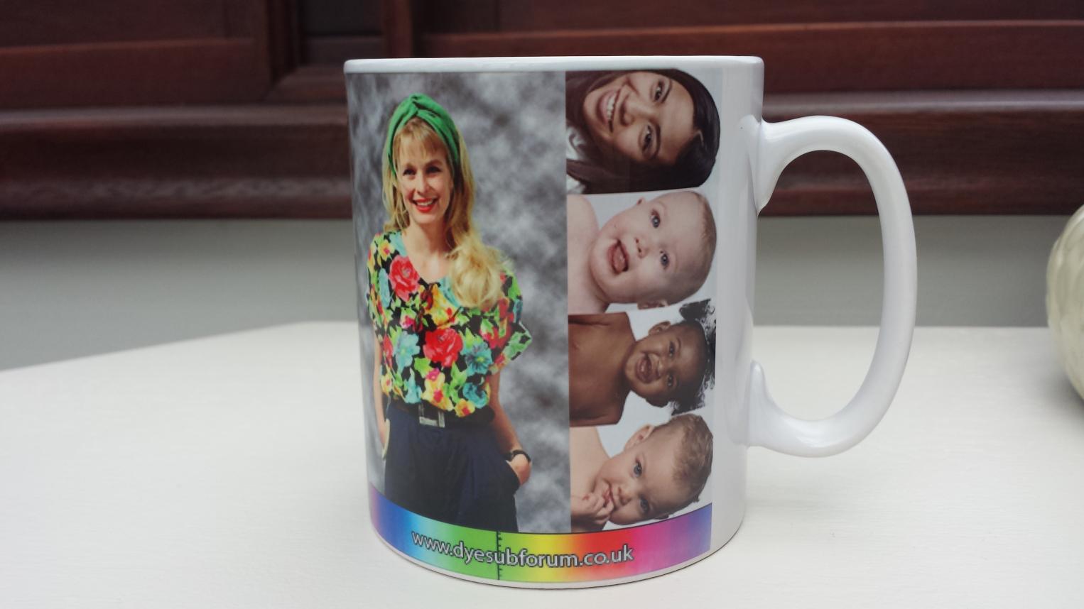

Well I've tried Paul's image as my first ever test mug.

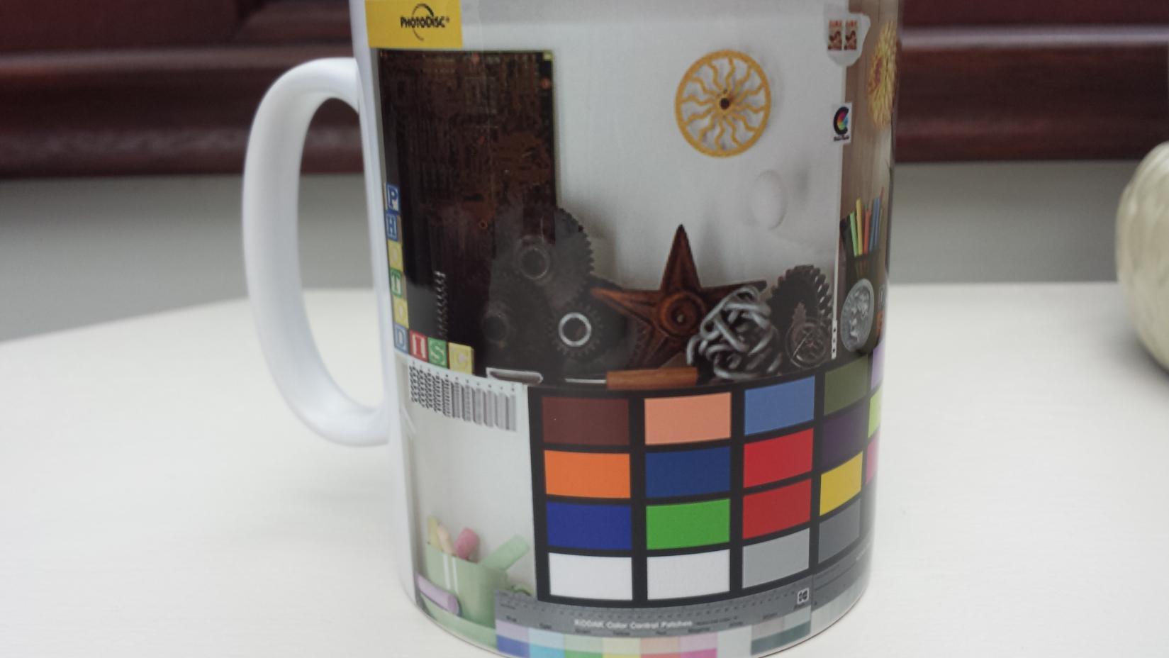

I notice that down on the first hand side, the coloured strip at the bottom of the mug, the colour is faded slightly and on the other side of the mug, I don't get as much detail on that wooden ornament as the sample image.

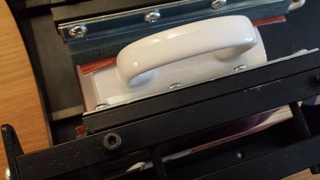

To my mind the heater band is sitting skewed so I think this could lead to cold spots at the edges - am I right?
Any suggestions as to how to improve?

It looks pretty much the same as mine, make sure those 4 allen bolts that secure the heater band are tight as with use I found they got loose and you lose pressure. Fading at the bottom of the mug may well be a taper issue, try leaving a slightly bigger gap from mug bottom to the image. I also make a point of pressing the mug centrally in the press, I notice yours is up one end a bit. This issue with tapering seems to be afflicting alot of suppliers and seems to vary from box to box and batch to batch. A right pain.
