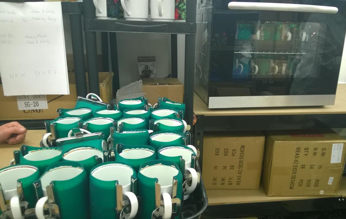

WP_20150630_11_38_27_Pro (2).jpg (91.52 KiB) Viewed 339 times
Run of 150 mugs in progress this morning.
Still need to get timings analysed, and do next run, as we had 3 people on it today and there were too many 5/10 minute breaks waiting for the previous batch in the oven. So, we'll do again with only 2 staff on it, and it should flow well.

What are your thought on increased print area and print results as compared with your mug presses
Re: New Mug Oven
We printed pretty tight on the presses, so not much size difference but printing tighter to the artwork edge, so less wasted/badly printed stock. Print quality more consistent all round though.
Will post again once i have confirmed timings, staffing etc, along with electric usage.
