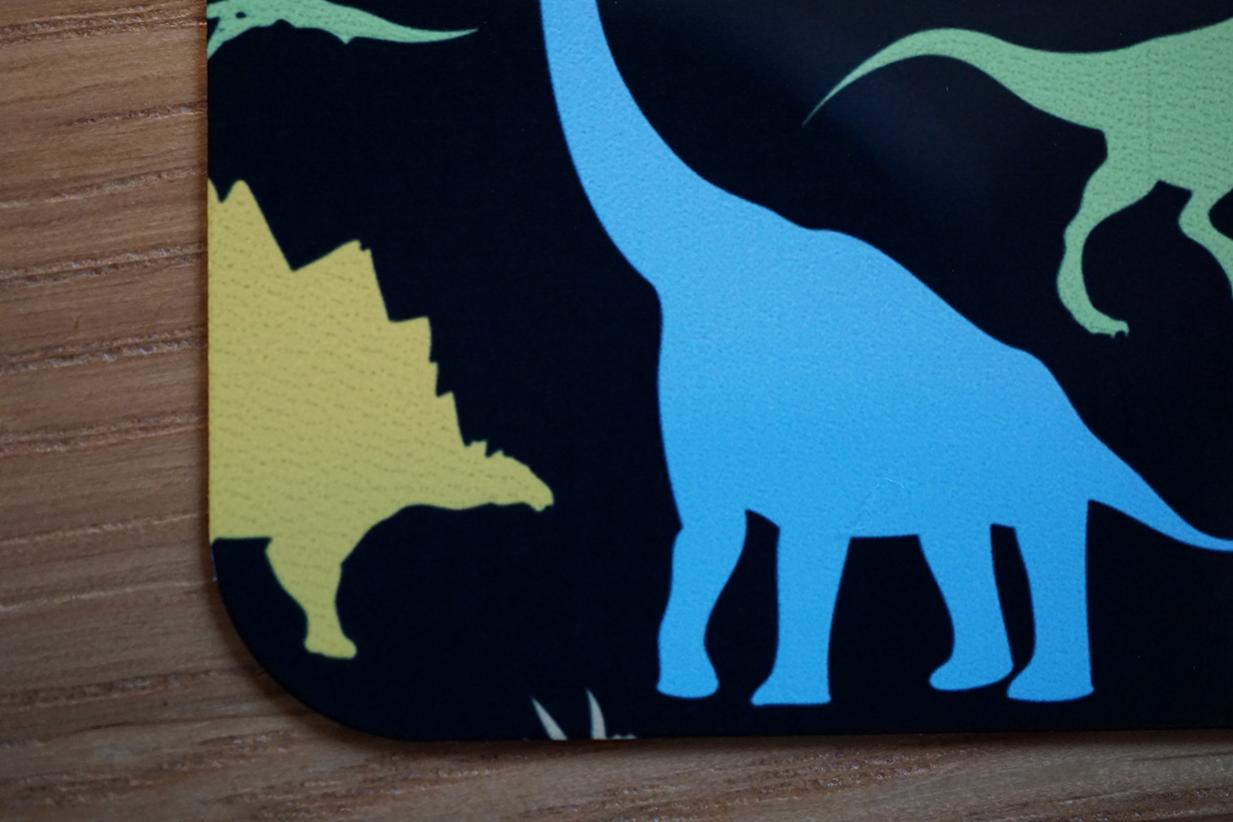

Okay so there is definitely a fault somewhere. Strange that I've seen it happen in two separate sg400's and other people have reported this problem.

really hard to make out in the pic but it looks like a dithering problem

mags1892;110275 wrote:really hard to make out in the pic but it looks like a dithering problem
Would that be a software or hardware problem?
mags1892
Re: [Need feedback]Epson Artisan 1430/1500W
Post by mags1892 »
software there a dithering pattern option in the driver try altering that but its looks pretty rough i can try same tint on mine see if its different if you tell me what it is

Post by halcyon »
Thanks! The colour is #F9F3DB

ICC or Powerdriver ?. Worth printing a gradient that includes your problem colour, strange things can happen with colours outside the printer colour capability. Are you printing anything else ?.

just printed it on my 3110 its a smooth as a babys behind, id say you have either an ink issue or a settings issue.

I tried changing the speed settings in powerdriver but that didn't really make any difference. Sawgrass are currently looking into it, they aren't sure what's going on with it.
