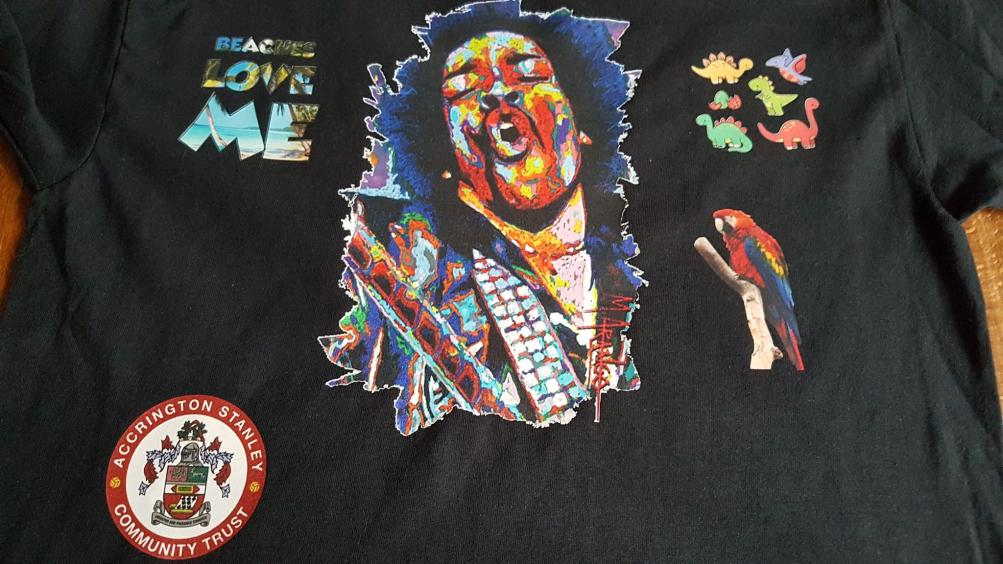

[ATTACH=CONFIG]6163[/ATTACH]
This is a mess about with the new siser easy subli. I will wash this garment over the next few days and provide feedback.
One issue I have found is with the mask not transferring the vinyl from the backing to the carrier very well. This isn't an issue on larger chunkier logos, but is hard-work on more intricate lettering and details.
I am going to try the following and report back:
Print design (minimum ink saturation needed)
Dry design fully
Cut design using a lower cut force.
Weed design
Stick transfer sheet to design, pressing down where needed with palm of hand as instructed by siser and leave for 10 to 15 minutes.
This is a known issue and I have seen a few reports, so I will try the solution and let you know how it goes.
Dry design fully
Weed design
