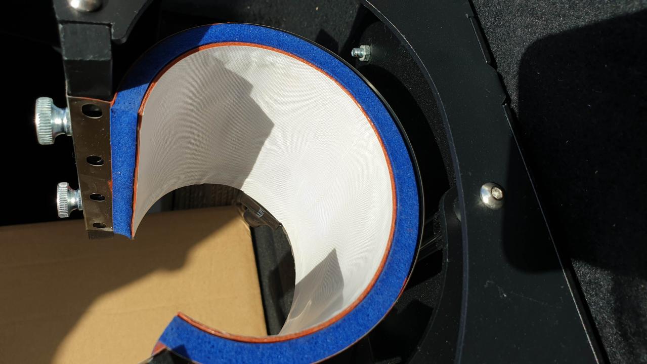

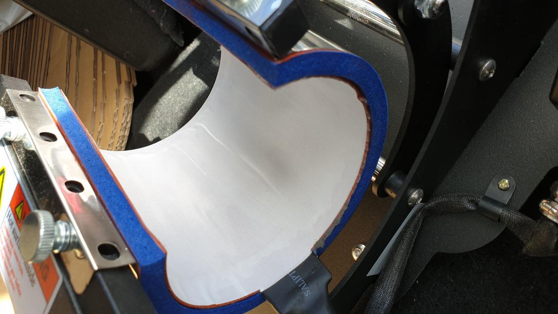

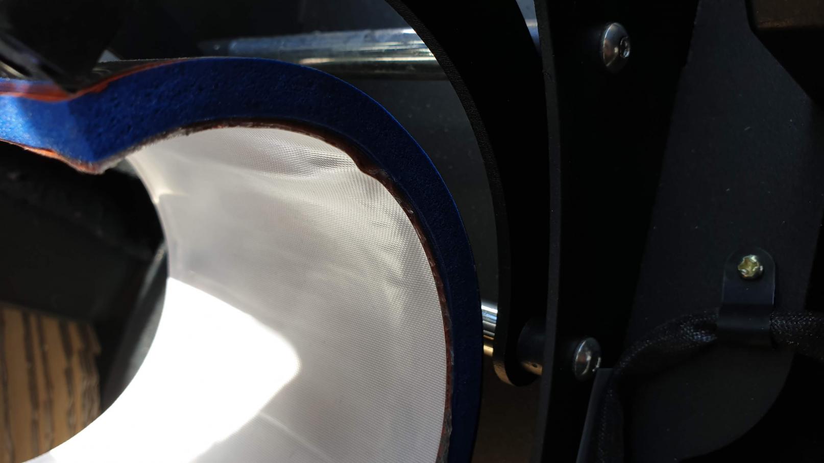

Didn't get to see anyone at MDP today as they were short staffed. The print's I was getting were either perfect or ink not fusing where the mug surface dips ever so slightly near bottom of mug or the ink didn't fuse on the left end of the mug as it seems the element didn't heat up evenly to the left side.
If you look at the pics the element/sleeve had creases in it too. So hopefully when I go again they can give me a replacement.

extrachewy2003;144696 wrote:Didn't get to see anyone at MDP today as they were short staffed. The print's I was getting were either perfect or ink not fusing where the mug surface dips ever so slightly near bottom of mug or the ink didn't fuse on the left end of the mug as it seems the element didn't heat up evenly to the left side.
[ATTACH=CONFIG]6334[/ATTACH][ATTACH=CONFIG]6335[/ATTACH][ATTACH=CONFIG]6336[/ATTACH]
That element is dead :(
I have had a few go like that.
extrachewy2003
Posts: 6
Joined: 04 Jul 2020, 17:33
Re: MDP vs Novachrome mug press
Post by extrachewy2003 »
I thought so, only had it a few weeks. Gonna see if MDP will replace and pick up a spare too.
Mrteajunkie
Posts: 1237
Joined: 13 Nov 2016, 21:59
Been thanked: 3 times
Post by Mrteajunkie »
I keep two spares as the element seems to fail quite a lot.
they are good though they have replaced them every time.
on a plus note they are only £18 to replace too.
