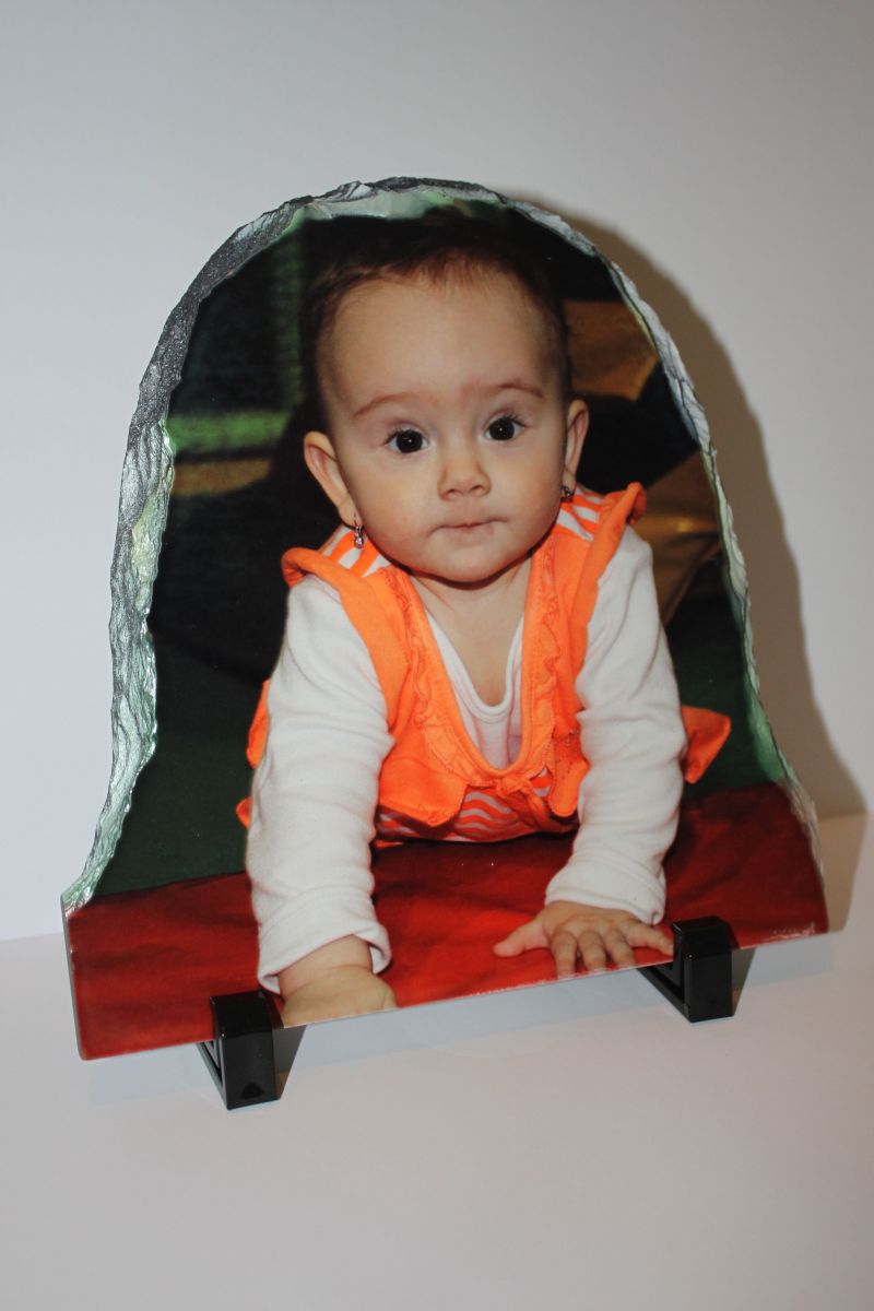

Michal you dont want to increse preheating tim just yet. Otjerwise you wont onow what was wrong :-) 1 thing at a time budy. Also if stone is preheated for to long sublimation process will start before you menage to align you pic corectly. So preheat for one min only and increse temp and time first.

Hi, I am sorry, I forgot to put some update picture. I think that next Rock slate is allright and I can work with this setting.
[ATTACH=CONFIG]878[/ATTACH]
1. pre-heat Rock slate and silicon mat for 60-75sec
2. dry transfer paper in press for 5sec
3. press trasfer paper on image for 480sec
vB_ID:878
vB_ID:878

Looks good buddy. Glad you sorted now!

With some help from members guys, every problem is solved. :)
Thank you all.

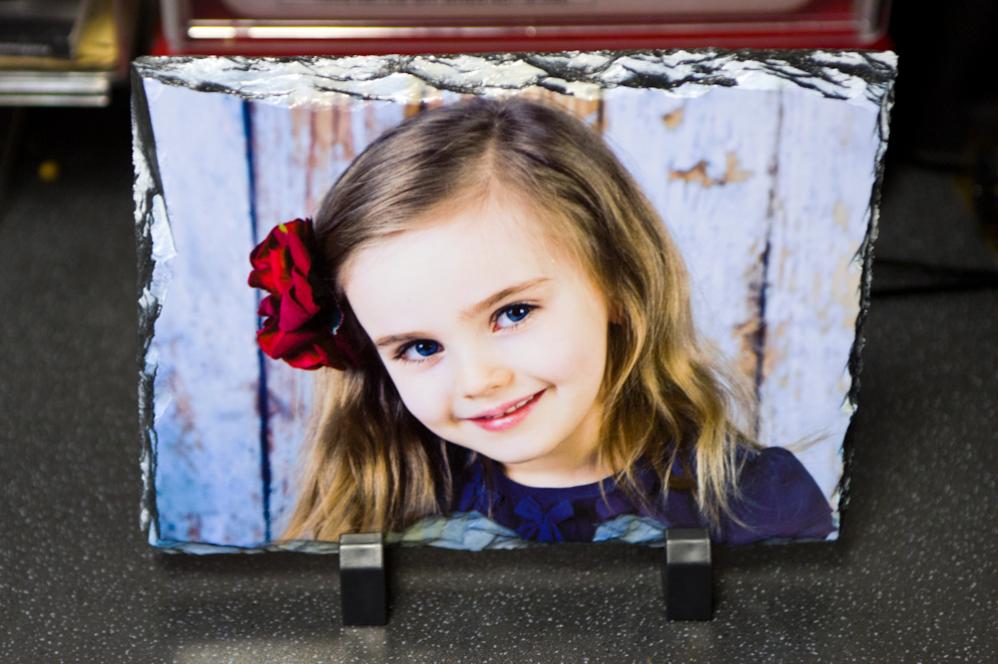

Been having fun getting the slates right - think i have cracked it. First couple had the paper sticking but once cooled i wet it and it came off no problem. Put the last one in for an extra 30 seconds and that seemed to make the difference.
[ATTACH=CONFIG]904[/ATTACH]
vB_ID:904
vB_ID:904

That looks really good, are these big sellers for those that do them?

You beat me too it John was just going to ask the same. (you type too quick for me)
Theay are looking good, although not my cup of tea personally it may be something my customers would go for.
What sort of price do they retail at?

They look really good guys......congrats on sorting your problems.

I have only just started offering them, had a lot of interest from clients who have been in the past couple of days so hopefully they will sell well - the 5 by 8's i am selling for £35.
