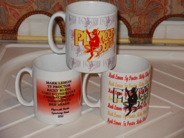

Just found out i can upload a picture, not sure what's going to happen, but this is with the Ricoh, and using my mugs, note how well they print top to bottom.

xpert;67745 wrote:Just found out i can upload a picture, not sure what's going to happen, but this is with the Ricoh, and using my mugs, note how well they print top to bottom.
Brilliant..love them :)
