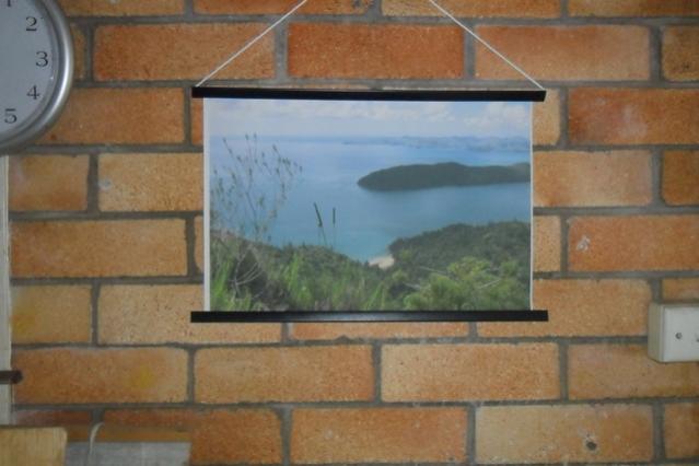

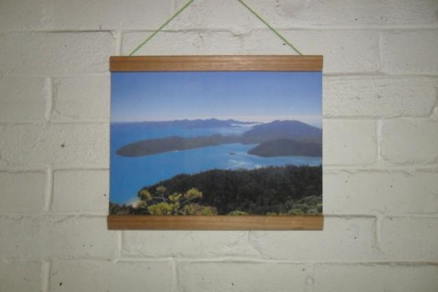

Here are a couple of rejects I kept from when I was experimenting with ideas and methods of hanging them. I have settled on a simple cost effective and more buyer friendly method since then, but it will give you an idea how the idea started out.
If you look again at the beginning of this thread, I hope you'll see it is not an advertisement for Brother printers
The only possible reason I can see for you to choose a Brother over the Epson Workforce WF-2650-DWF, is that some Brother printers are A3 size and I believe the Epson 2650 is only A4. If you plan to print small canvases I think A3 is a necessity. I tried A4, they look lousy. As you will see below, even A3 is small.
However, Epson have some A3 printers that are affordable. And you have a place nearby that sells Epson. It will probably cost you more to import Brother printers with no support than to use Epsons with support.
So some of the things you would need to ask Epson.
Can you get large refillable cartridges like the ones we use in our Brother printers?
If you can't, can you get an easy to install CISS?
Do they have an A3 model that will take A3 canvas sheets?
Can you get bulk pigment inks that are affordable?
By using Brother printers with Epson inks, you will lose some of the vibrant appearance of the colours. Especially if you choose to use the newest Epson inks, and if you can get a high quality white canvas. I make prints for a mass tourist market for people who buy on impulse, and are not looking for the highest possible quality. And I use my own photos, so only I know if the product is the same as the original. They are simple A3 hangings (not stretched). Just hung like a poster.
