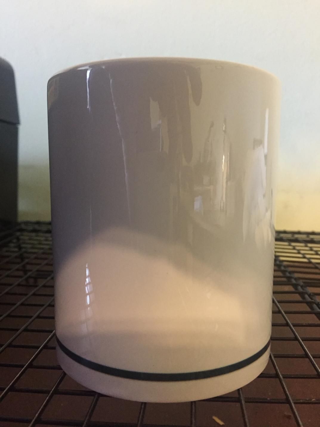

So Dye Sub Supplies (DSS) sent me some mugs to take a look at and review. Before I write my review I will say that I have no loyalty to DSS and in fact have consistently stated that they will not get my business due to Listawood being 5 miles up the road from me. I am always fair and honest whenever I review something, pointless doing so otherwise.
In short, I see absolutely nothing wrong with these mugs. In my opinion they are a really nice white mug, nice to touch and really smooth inside. The manufacture quality of the mug is definitely one of the better available and would have no hesitation in using them.
I have printed on two of the four mugs sent. One I did for a mate as a birthday present. I did tell him that the mug was a sample and should it fade or deteriorate in anyway then to let me know. I will report back should he say anything. The other one I printed as the picture shows. No adjustment to the artwork and wrapped the same way I wrap any mug. I have measured the line at several points and the variance is less than .5mm. It is fair to say this could be my wrapping, and I certainly think it is well within the standards I expect.
These are 11oz mugs, personally I prefer the smaller 10oz, but I know many of you prefer this size and if you do, then I would certainly recommend giving them a try.
