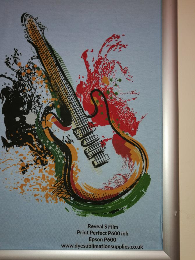

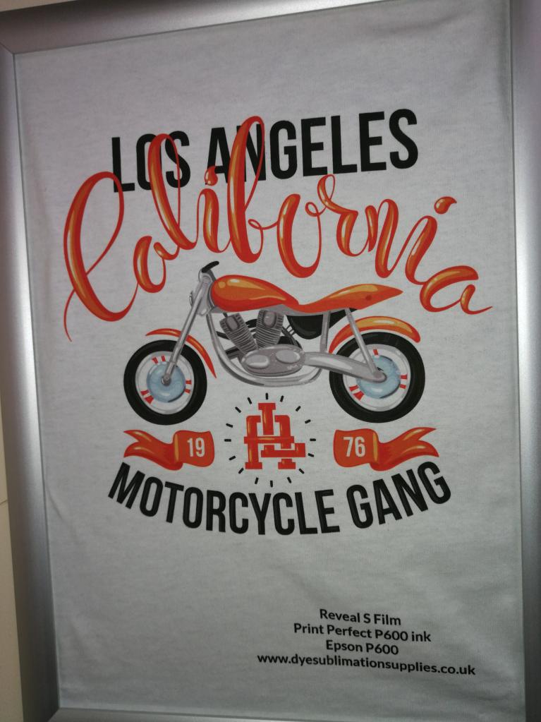

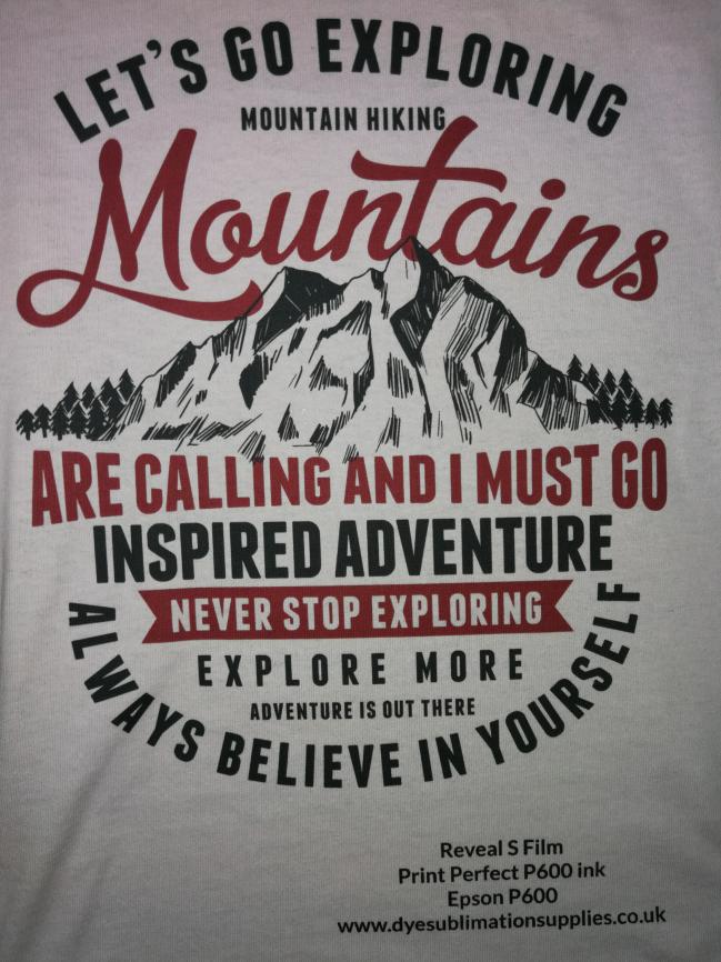

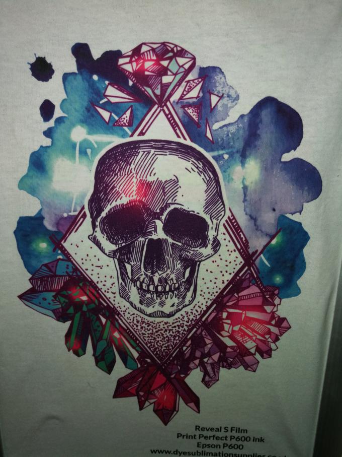

A few images of t shirts printed with the Reveal-S.
Regarding gradients the skull one show that off very well

Gradient on black would be brill to see :-)

socialgiraffe;132522 wrote:Gradient on black would be brill to see :-)
Yes, this is what I'd like to see too. Especially how well fades to the cotton colour and gradients work out.
The only way transfer papers on dark/black cotton t-shirts will ever challenge DTG is the ability to print fades and gradients - DTG does this all day long with ease - if you have a good RIP :)
