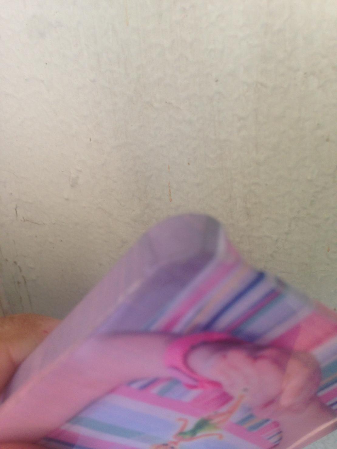

Tried to make some iPhone cases according to the manual by ArtyGamer but did not manage to get the corners that good. Corners are pretty ok when I use film though. But there is also a problem with the front edges, please check the image.
[ATTACH=CONFIG]2792[/ATTACH]

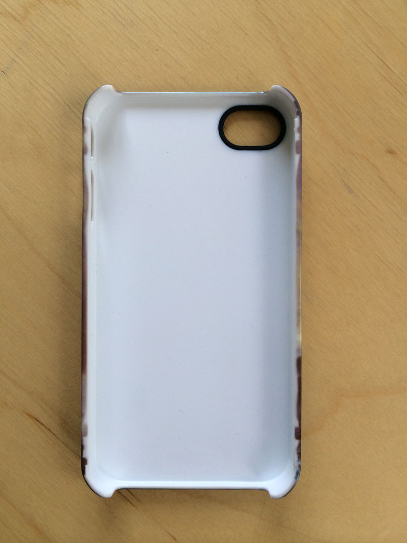

Re: Trying to find a solution for iphone blanks corners... We can do it! :-)
[ATTACH=CONFIG]2864[/ATTACH]
Its a terrible picture, but it gives you the idea.
