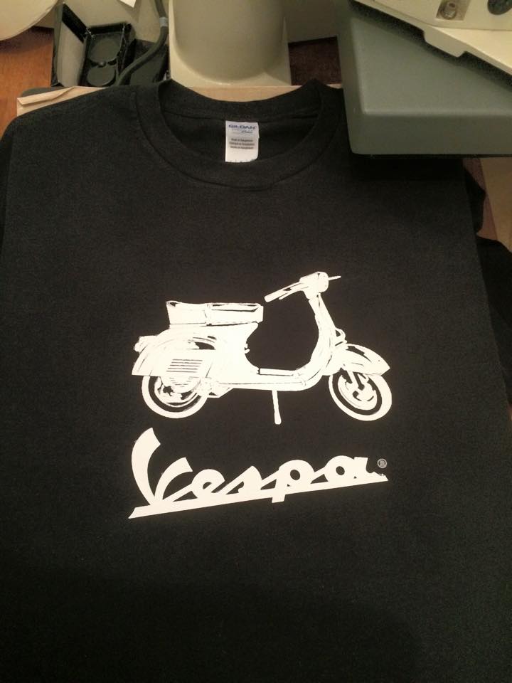

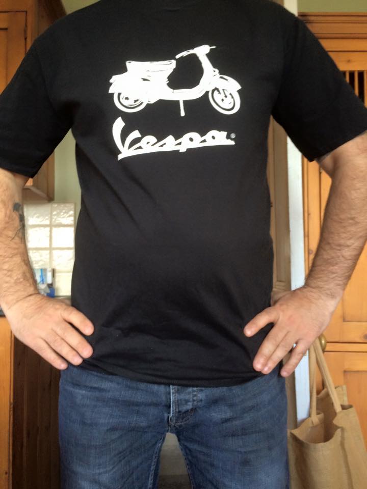

After not getting much custom for my white printer over the xmas period i decided to make myself a t-shirt this morning, i will use this as my experiment top and give it 100 washes to see how it lasts
anyway after struggling with getting to grips on the masking side of things i finally got it and turned a black image of a vespa into a red one (colour needed to print white). i must admit i have struggled to get the perfect temperature for peeling away the adhesive backing to the transfer paper to stop bits of the image not sticking but today i used 125 c and 35 sec press which is slightly higher and longer then recommended but this worked perfect for me today. yes i know its a copyright image but this is a tshirt for my own personal use and not for resale (unless i get an awesome order in for them then i could be persuaded
i could of done this in vinyl but i do like the feel of the print and it does give it that screen print finish, not justified by the model in the images. Dave

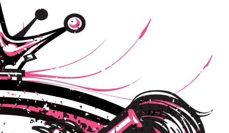

I agree with you David and the garment is looking good. Out of interest how would it handle the below. I have just been sent some samples to print for another member and one of them included lots of swirls as highlighted below. These swirls are about 1mm width in a light pink, how would the SA system handle that?i could of done this in vinyl but i do like the feel of the print
