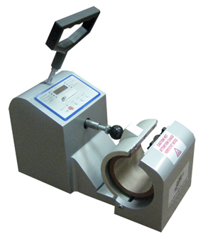

John G;18918 wrote:This could be to protect the mug blanket - I leave a sacrificial (old) mug in the press at all times, even when switched off. When you come to use the press switch on and when up to temp take the sacrificial mug out and put the mug in to be printed. I think it helps to keep the blanket in shape!
beat me to it John - but I used more words :-)
Re: Is this normal?
[ATTACH=CONFIG]163[/ATTACH]
Is this your press? If so, it's same as mine. As John mentions above, I leave a plain mug in when warming up/cooling down.

Yup, that's my press...so you switch it on with an old mug clamped in place...let it reach 180, take that mug out...stick the prepared mug in...as soon as you close the handle, it starts the count down...when you've finished all your pressing, you put an old mug back in and leave it to cool down with old mug in place?
Is that the process? Whoops - I let mine heat up and cool down in an unclamped position without a mug in today...

Re: Is this normal?
That's exactly it ;-) Don't panic about not having a mug in...just don't keep doing it! lol. You'll find it a great press, I was going to say cracking but that would be a poor choice of words!

Bit a non essential question...but the sacrificial mug...can it be my first one - that was a bit splodgy...or does it need to be a plain one?
Wasn't sure if putting a previsouly printed mug in a warming up/cooling down press would cause anything to come off on the press??

Re: Is this normal?
Use a new plain mug. The image off the printed one may ghost if it gets above a certain temperature...basically the sublimation process will start again.
