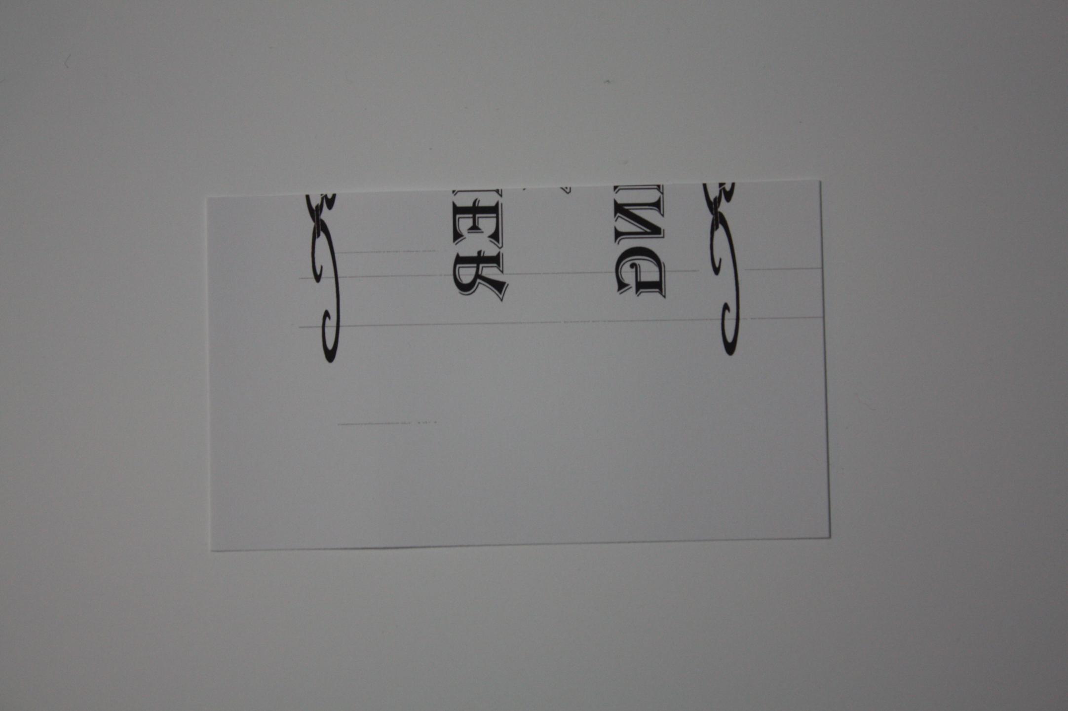

Ricoh sg 3110 dn (about 5 years old)
Trupix
Sawgrass Inks
Whilst we are on lines......
This printer sits on the shelf these days and gets fired up probably once a month and run for a day or so then goes back on the shelf. Prior to being the reserve printer it was rather active!
These lines appear, not always, but quite regularly. The lines are in the direction of the print head travel. Has a nozzle died?

Your marks are in the direction of the paper feed, so this would imply either wheels (already mentioned), paper contamination (are both papers from same source?), blank contamination (already mentioned), or press contamination (ie on the membrane).
