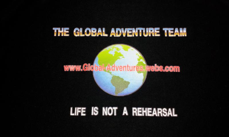

Ok Fella's, Here's 'Muppet 1'
[ATTACH=CONFIG]2004[/ATTACH]
It's a bit 'Wonky' for the reasons outlined above, in my previous post (Confused about lack of control)..
But I am sort of happy with the colours, the Black is a dark Grey but the others are ok for first attempt.
The Contour Cut was not close enough, there is some white showing but I can increase the size of the Black 'Stroke' to combat that (Will be wanting to get this perfect though rather than a compromise).
I need to perfect this Template, maybe make certain elements bigger and possibly change some colours.
Overall I am not at all happy, but it's ok considering the lengths I just undertook to make this (Muppettry) - I can see now what I need to work on but most of all I need application tape otherwise this will be an absolute nightmare.
I have already sold 15 of these at a great price, this is because the buyer knows I wont sell anything unless it is at least 'very Good'.
vB_ID:2004
vB_ID:2004
Re: FlexiSign 10 Black Lines over everything.
why don't you just get me (or others on here) with a print and cut machine to print the whole thing out on one sheet which you can then weed, apply application tape and then print.
The result will be considerably better, far far easier and a lot less hassle.
If you have sold them at a great price then you probably have enough in it to spare a few pennies

NikGrey;77797 wrote:Ok Fella's, Here's 'Muppet 1'
So is that contour cut onto yolo papers?
