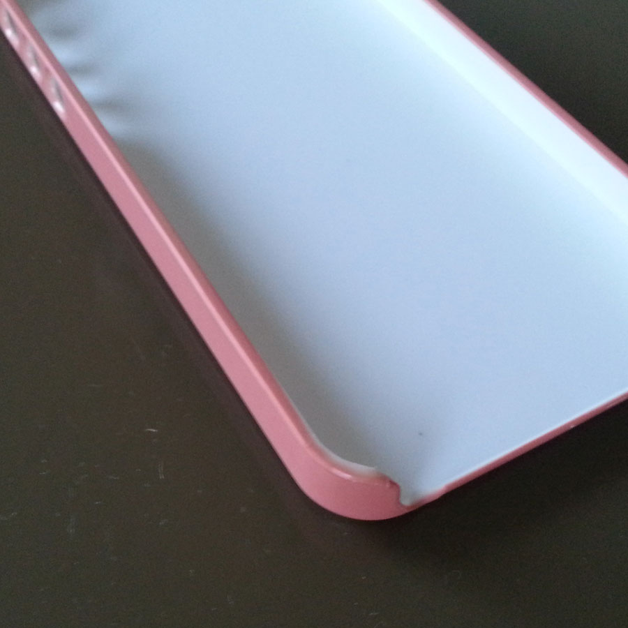

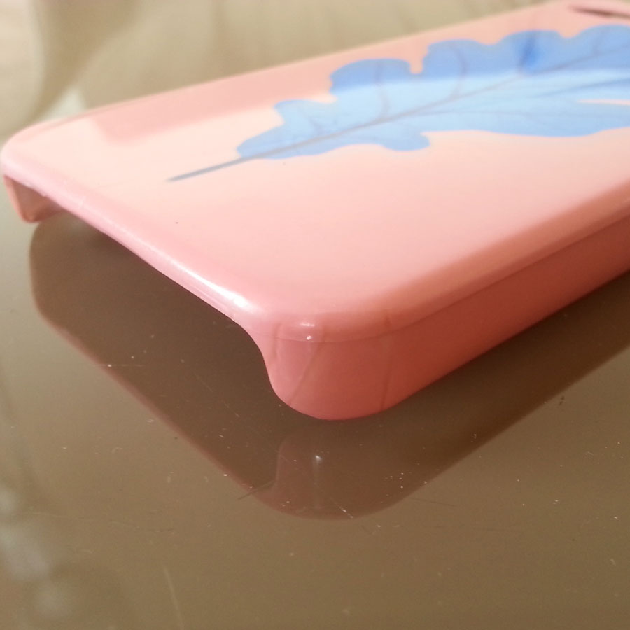

Hi everyone, I have now done some testing with my new 3d press (st3042). I've tried artygamers method but it doesn't quite work for me. The main issue I get is crease marks on the corners. Does anyone else get these marks with this method? Does anyone know if there is a way to solve it? Image below illustrates the issue:
[ATTACH=CONFIG]2917[/ATTACH]

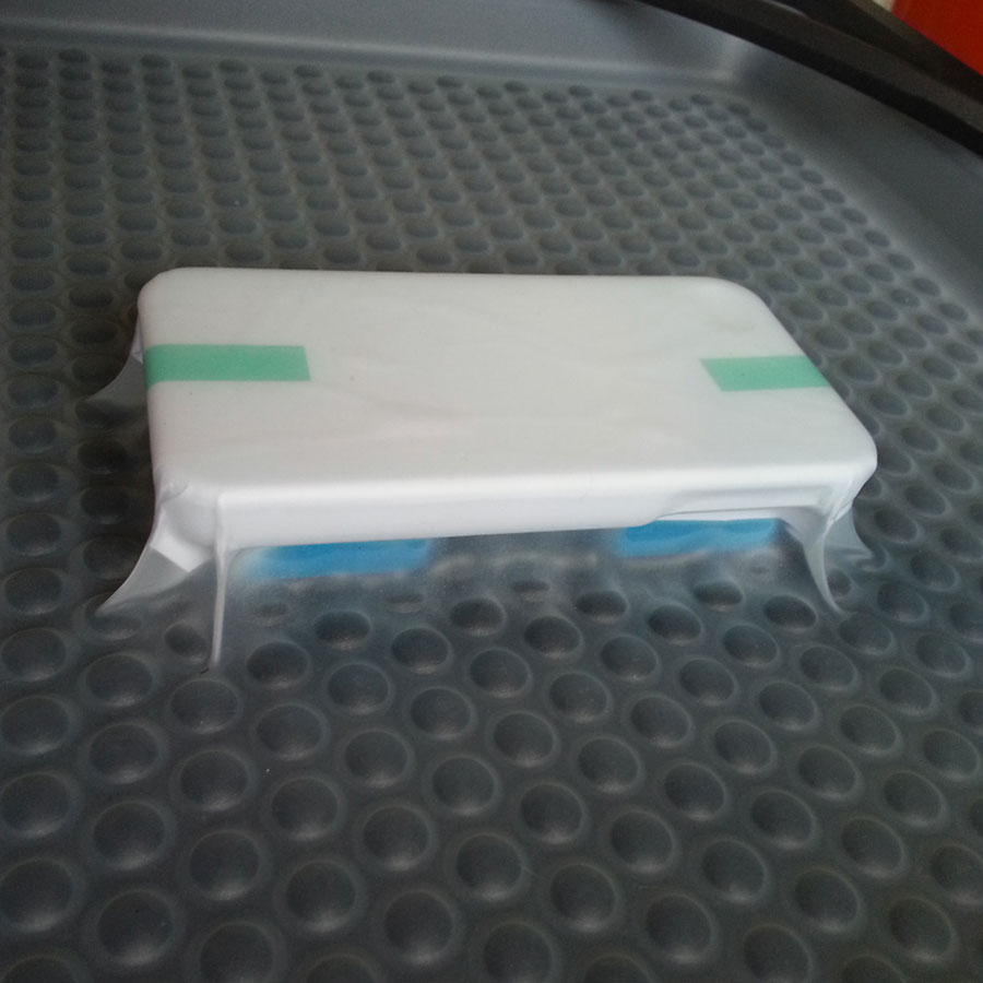

I've chosen a light solid colour for my tests to be able to see any corner issues. I also include images of what the case looks like in the press and the vaccum pressure I'm getting:
[ATTACH=CONFIG]2912[/ATTACH] [ATTACH=CONFIG]2913[/ATTACH]

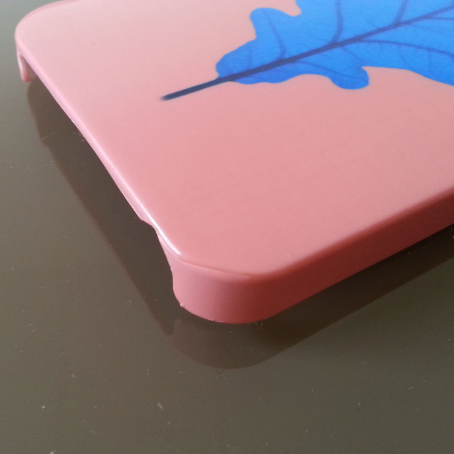

I've been getting better results with hand wrapping the cases, cutting the paper exactly to shape to avoid overspray on the inside. I still get crease marks but by hand wrapping I have control over where the marks appear and I only get one mark on each corner, see image:
[ATTACH=CONFIG]2918[/ATTACH]

Anyway I wish the method developed by artygamer would work for me as it would be faster and easier than hand wrapping. Any suggestions on how to avoid the crease marks I'm getting would be greatly appreciated
Regarding the printing of the front edges I assume it depends on: jig shape, case shape, vacuum pressure
