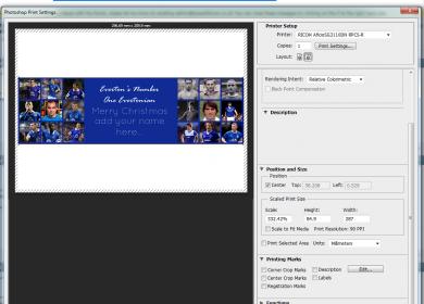

The frustrating thing is when I try and resize the image using the scaled print size -
When I change the height, the width automatically changes and vice verse
If I select scale to fit media, the image is printed out far to small.
vB_ID:3083
vB_ID:3083
Hoping someone can help. Not sure what way to turn

"contain proportion" selected will resize equally. ie double width will double height, deselect and you can input sizes, but image will distort as the image proportions will not be equal. ie double the height leaving original width will make the person look like a giraffe.

Hi Skye, thanks very much, the templates I have made are at 300dpi
I have just checked the image / image size and the same thing happens, When I try and resize the image to 185 x 70mm and un-ticking constrain proportions the image then is far to big on the print preview.
I dont understand why I am not able to print the image I have created in the size it was created.

Hi Thanks for the replies.
I have managed to figure this out, I was using 300dpi settings on my templates.
So I created a new template at 72dpi with 9cm x 21cm and these are printing out perfectly now.

I wouldn't be using 'screen resolution' of 72dpi for Mugs, too low.
Make a template of 210 x 90mm at 300 dpi and save it as your mug template, 72dpi is far too low :(
