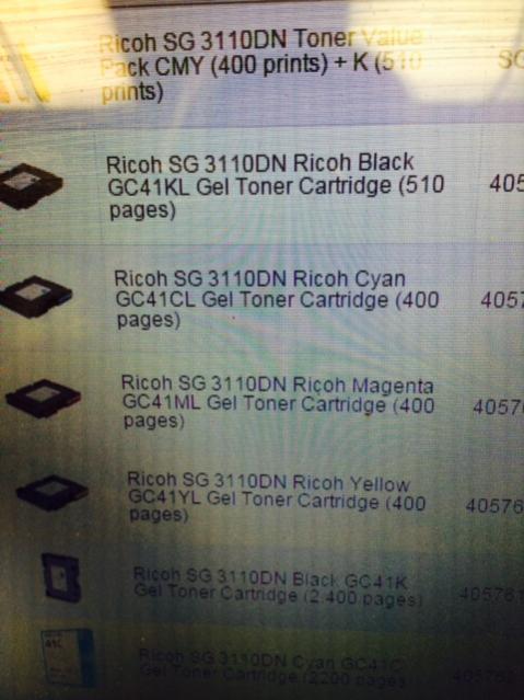

Its the ink that came with the printer? ah its gel ink thats not right is it??

I think its all gel ink in the Ricoh's but is it Sub ink where did you buy it and what did it say on the box the ink came in

by Claire
vB_ID:3380
vB_ID:3380
this is what printer came with x

Thats great ink for invoice printing but no good for sublimation and you don't really want to put that stuff in the printer or you are going to have to flush it ALL out.

Ricoh sublimation ink is called SubliJet-R 4 carts will cost you about £210 if you are a premium member on here you can save 10% with some listed suppliers oh plus postage.
Or £310.80 with a new printer (£279.72 for premium members)

Yup I'm afraid it looks like you have installed the normal Ricoh carts that came with the printer and not sub inks. As afterMo has said you would need to buy a set of the above carts to get it going but sounds like you will need to flush the system. I will leave that to someone with a bit more knowledge about these thing than me I've never had to do it so not sure. Hope you get sorted.
