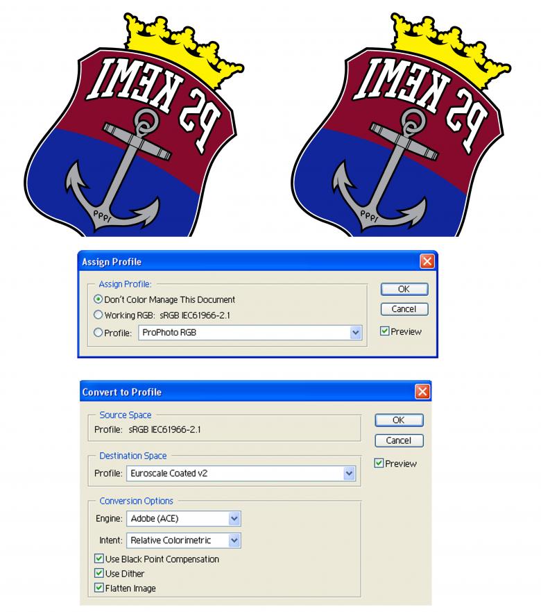

What settings do you mean, for example? Because I have not deliberately edited the settings in Photoshop.

Re: 33110DN - Problem with colors
Posted: 20 Aug 2018, 12:27
by Justin
First thing you needs to do is check all settings against SG support website, for a start you might want to double check that Intent setting. I appreciate you would have done this during install but settings can and do get changed so check them over before we go any further. Remember, you're paying a premium to SG for these inks because of the support you get so make sure they check everything for you as well.
Posted: 20 Aug 2018, 21:26
by technick
Assign SRGB 2.1 as the working RGB profile.
If you are not using powerdriver, the destination space should be your custom ICC profile, not Euroscale.
If you are using powerdriver it should be SRGB 2.1 and the printer output would be powerdriver and not the printer.
