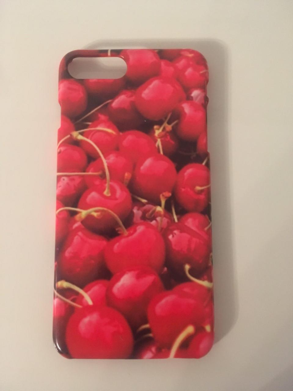

Here is a picture of the cases we design ourselves that dont cause me these issues...
