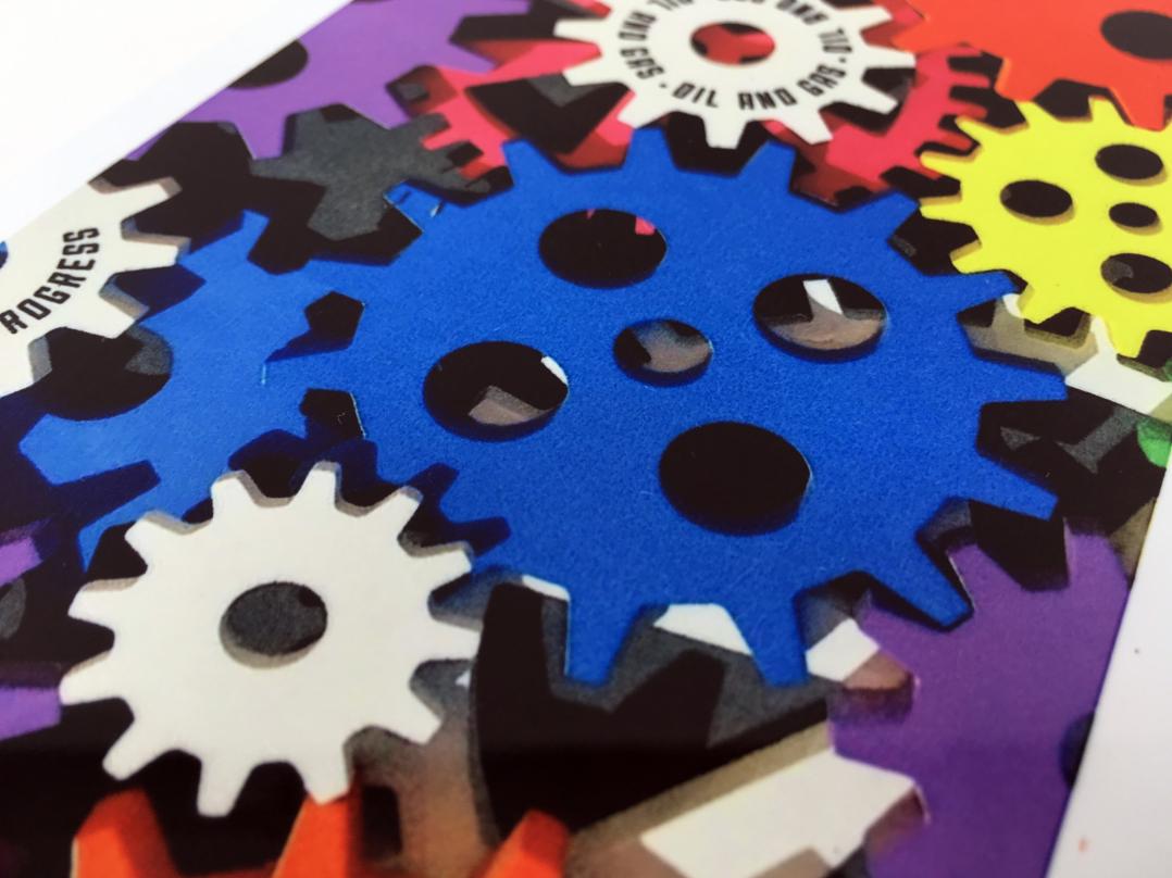

The first substrate test was on to aluminium sheets; we found one of the papers printed quite blurred (potentially due to the high release coating), on fabrics this is not too much of an issue as the weave of the fabric can 'hide' these types of imperfections in the print. However on aluminium there is no hiding this.
This was the 'patchy', blurred issue we found with one of the papers-
vB_ID:5890
vB_ID:5890
Note the difference produced from one of the other papers on the same aluminium sheet pressed at the same time-
vB_ID:5890
vB_ID:5890

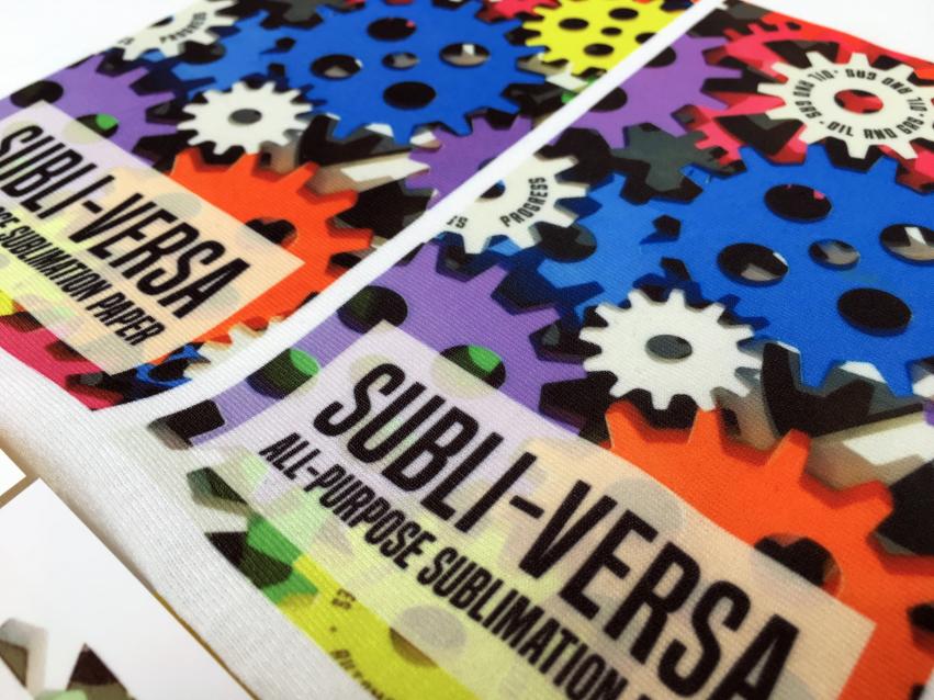

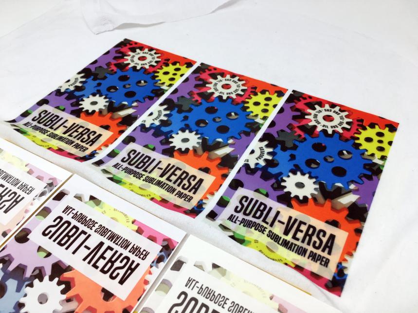

The next substrate to test was a polycotton t-shirt from Xpres, all the papers produced a good transfer on this substrate-
vB_ID:5890
vB_ID:5890
vB_ID:5890
vB_ID:5890

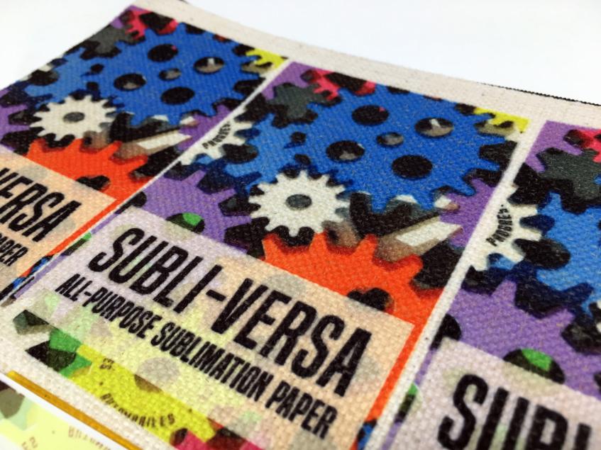

Next was a linen make-up bag / pouch. Being a thick weave and very porous fabric these can often look quite faded when sublimated on to so a good high release of ink of the paper is required for these. Again all 3 tested very well on this substrate-
vB_ID:5890
vB_ID:5890
vB_ID:5890
vB_ID:5890

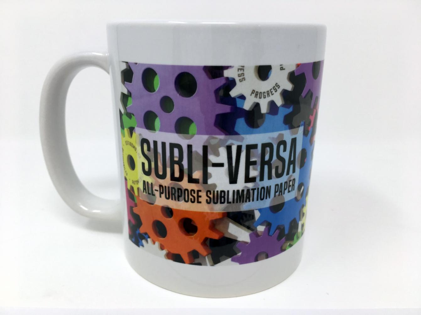

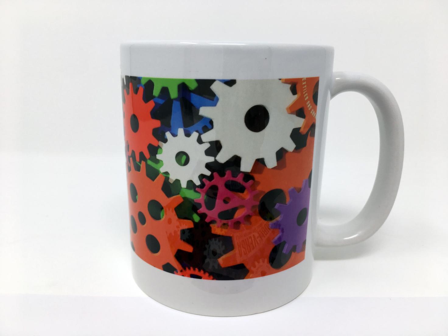

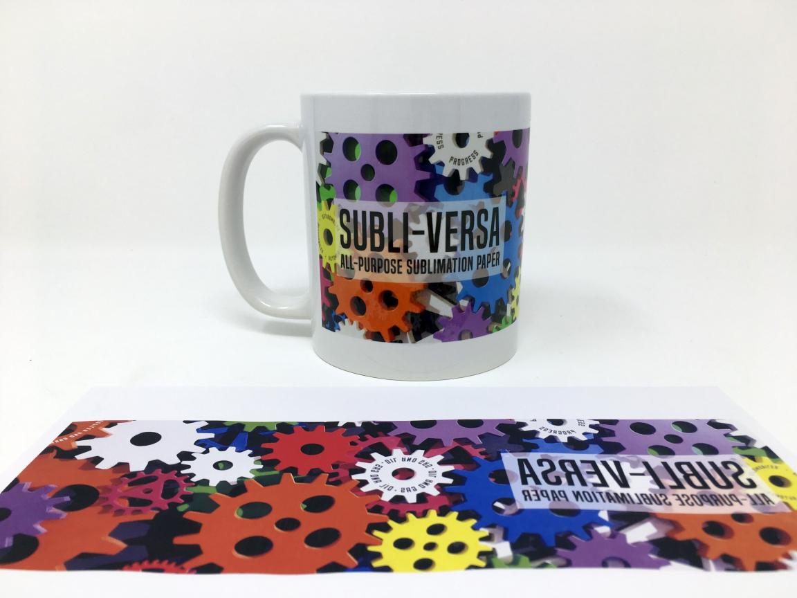

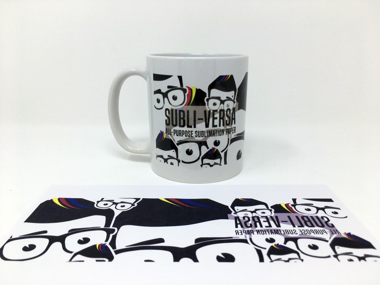

Last was the staple of sublimation.. the mug. Our Subli-Fabric paper often releases too much ink and / or the ink does not dry immediately so can make wrapping around the mug tricky if you need to re-position. So we were looking for the paper to be instant or fast drying (less than 10 seconds from being printed)
By this point, one of the papers was proving to be the most versatile and ticking our requirement boxes. We wanted to test the paper with a large area of solid colour as we often find these areas can look 'patchy' from poor ink release-
vB_ID:5890
vB_ID:5890
vB_ID:5890
vB_ID:5890
vB_ID:5890
vB_ID:5890
vB_ID:5890
vB_ID:5890
vB_ID:5890
vB_ID:5890
vB_ID:5890
vB_ID:5890

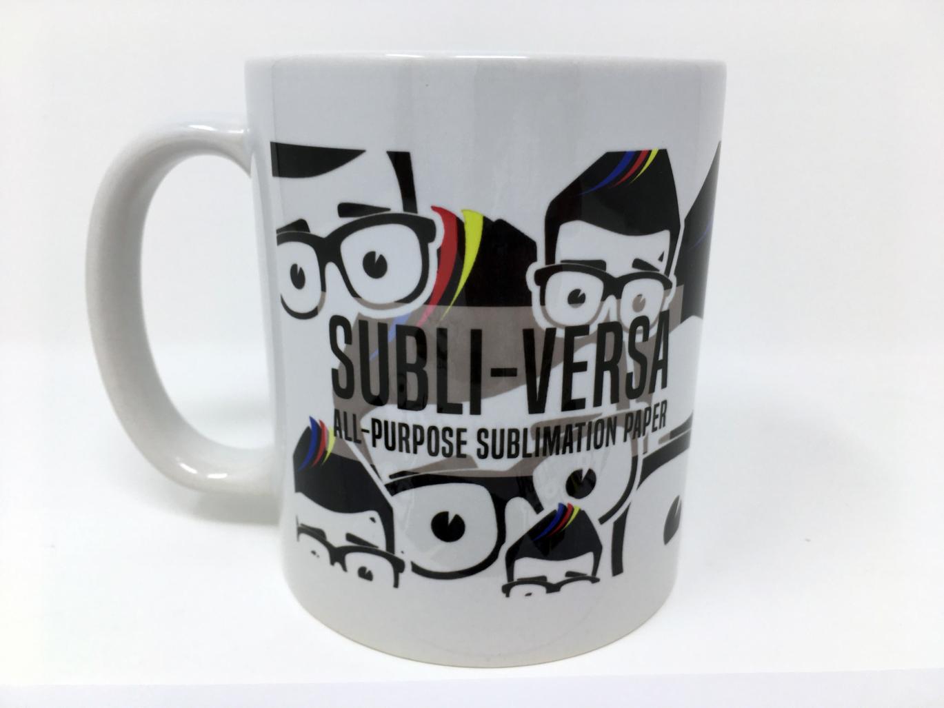

We were very pleased by the results, especially on large block areas of black shown below-
vB_ID:5890
vB_ID:5890
