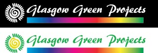

Its a complex logo with lots of fine white lines (and I do mean *fine* - less than .5mm at the size they want) with the company name under it in a Script font. It's a bugger and no mistake - they also want it to be around 8cm wide x 4cm tall.

As you can see it's a pain in the backside especially at such a small size, but a white version (with the rainbow bar) is acceptable to the customer on dark tshirts.

Re: Is an OKI C610 and WOW the way to go?
Definitely something for an OKI white system
If the total width of the logo is 95mm wide (for example) you can get about 22-26 on an A4 sheet. so 150 logos is only 6-7 sheets (plus say a couple more for overs).
If you do not have a white system then I suggest various members on here will be able to help.
I would but am a tad busy. Both Logo Bear and Jason have OKI White system and there are probably others who I have forgotten about. Post a thread in the member to member offers and I am sure someone will be able to give you a good price on these.
