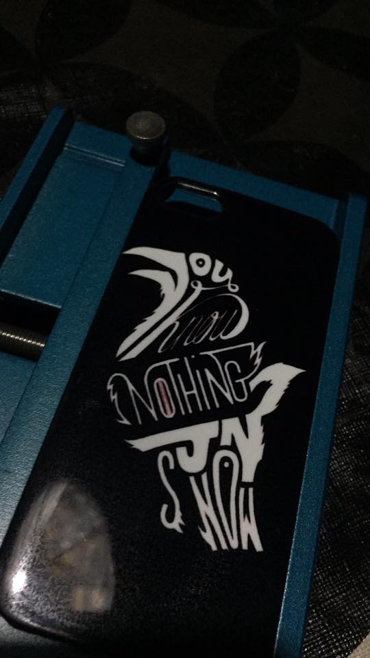

Im using the 3d mini sublimation machine. and an epson l120
When I print it it comes out fine, no red or magenta marks, then after i finish sublimating it this is the result, it always happen when I have black color or dark colors, some magenta comes out of the sides. here is the pic, can pls anybody help me, thankyou in advance.

ICC profile issue.

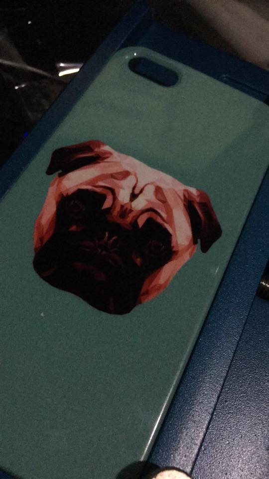

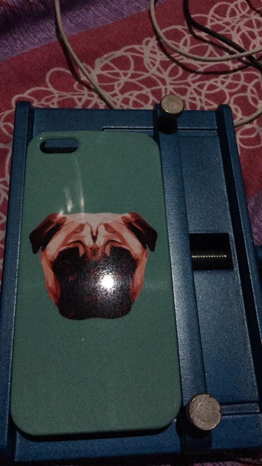

I tried doing what you said on ur website about the raster image tutorial, it came out good after I print it, then when i finished sublimating it its still the same problem, it becomes magenta. =/
Im wasting too much blank case and ink. I cant seem to get it, pls someone help me. Its really okay when I print it the problem is after sublimation.

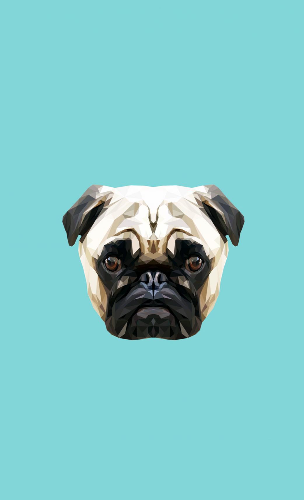

Please send a picture of the original image on the computer to see the difference
