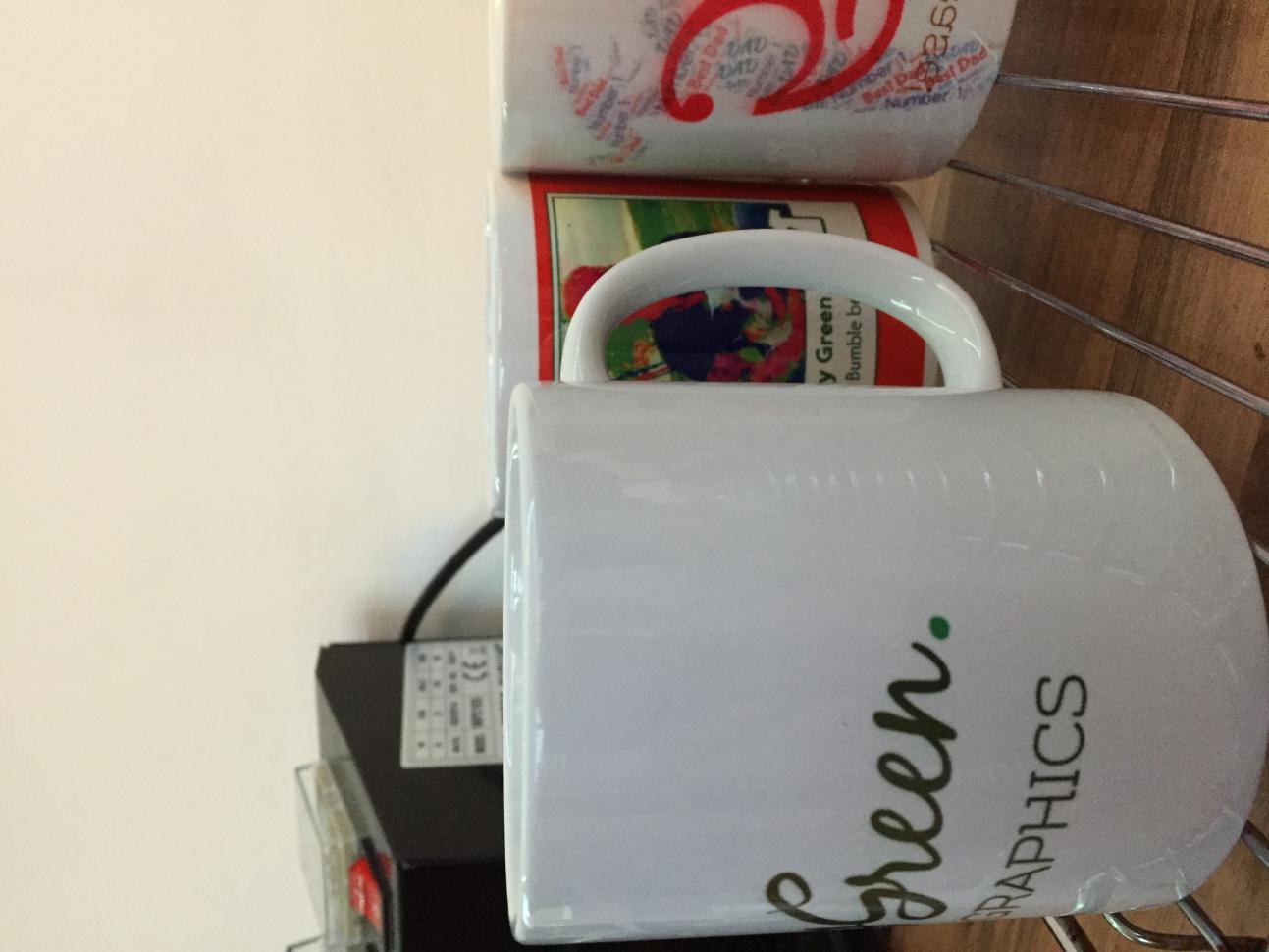

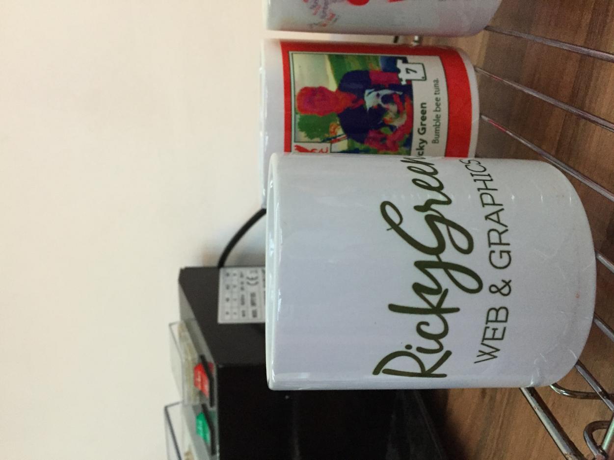

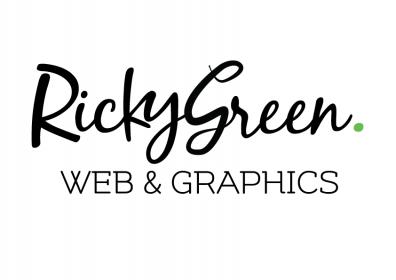

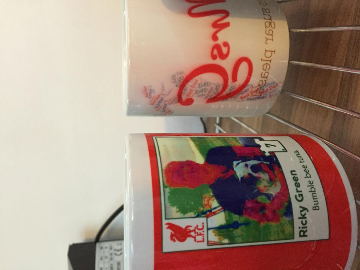

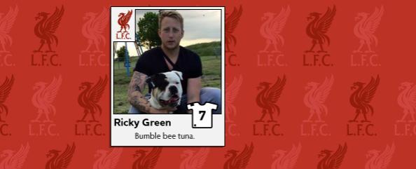

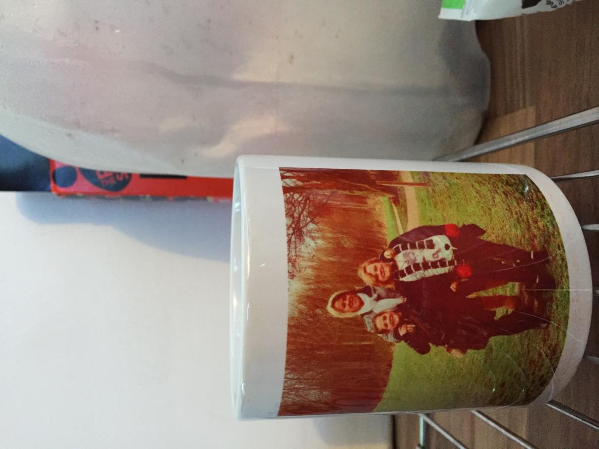

I've ran some tests, the first image is my last attempt, the color is very orange, this is the original.
So i tried a basic design, just my logo but the black isn't even black, its more like green
This is my first attempt, its awful
I've searched for DSF Mugs but it's not showing anything for me, the keywords are too common or something.
