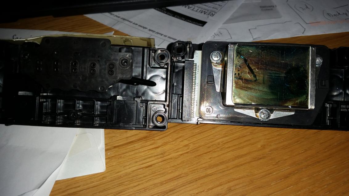

You can temove this from underneath its called the manifold .
See pucs
[ATTACH=CONFIG]3869[/ATTACH]

Latest nozzle check. Still barely there.
I am thinking try new damper and then go for the head removal. As this part worries me as it is very expensive.
Thank you mags1892 for your help and patience.

I cant see any air in the pipes but as mags pointed out that was some air in the dampers which I have got rid of now. All the dampers look the same now but i suppose that doesn't mean anything.

I was just interested to see if any ink was pooling around your carts. Your situation is exactly what I had with my light cyan, mine eventually came through but I got other issues like over-spraying, nozzle clocks etc.

try the damper first maybe swap the cyan and light cyan see f it moves over if not you have a head issue.
