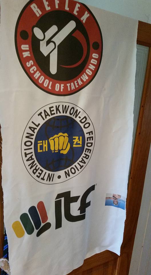

vB_ID:3954
vB_ID:3954
As Ink is one of my specialist subjects i did this asa test for table cloths, This is on 100% cotton printed on a wide format epson 9880 using a special pigment ink. You need to have a treated cotton and a pigment ink with a very high pigment content and binding agent. Then you need to heat normally through a tunnel dryer but you can HOVER a heat press ideally you dont want contact as it will flatten any fibers.
